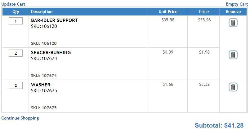

daveoman1966 3,880 #4 Posted September 20, 2019 Here is the cheapest Toro / wheelhorse supplier I've found.... and a shopping list for you too... https://www.psep1.biz/arinet.asp?aribrand=TO# 1 Share this post Link to post Share on other sites
