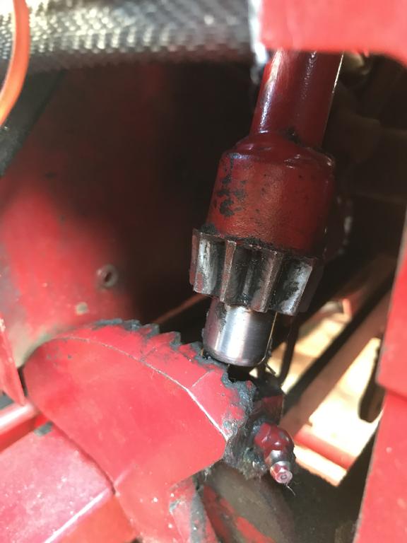

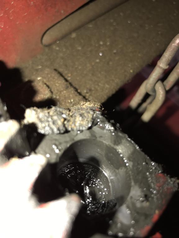

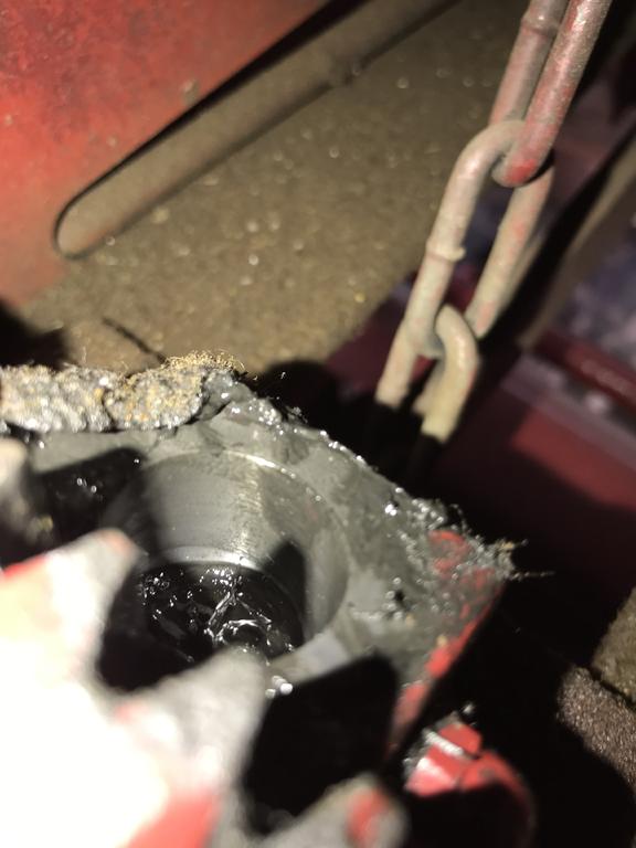

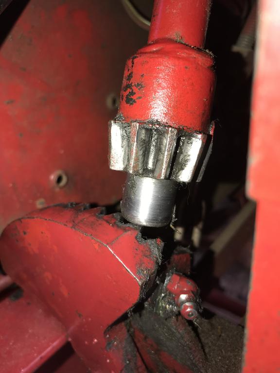

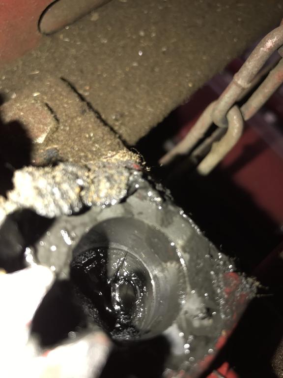

I need help diagnosing this one.  I have left-right play in the lower steering column where the vertical steering shaft goes into the lower steering support and meshes with the fan gear (pics attached).  The steering column fits tightly against the fan gear but moves about an 1/8 of inch off center left or right when the wheel is turned (Wheel Horse SK 486 - 1982).  I have ordered a new lower steering column support, thinking that the hole has wallowed out over time.  But I’m wondering whether the problem might be wear around the lower steering column rod where it fits into the lower support.  I have not ordered a steering column - yet.  Any thoughts/bets?spacer.pngD46728E0-4D9E-433A-9413-27906DFFDEFD.jpeg.941fd940547ac81ef080053da66f0f52.jpeg2E313F9F-E6A7-4259-B665-023F09518858.jpeg.7e461ce5d2b10181d26475bd47086017.jpeg7B6E0242-9C5A-4AE7-9660-36F631518C81.jpeg.e545df854017a14a64ced771edfd1c03.jpeg80200983-0808-4F03-BF20-5A826E068680.jpeg.75f78f0ba5eb0db2536fa3a049f810fd.jpeg2931957F-94AA-4F71-9C46-BE43A050C7B7.jpeg.af643f1cee59f726f17c744896f7aa0c.jpeg

Looks like there is a bunch of wear in that pocket. I have seen were folks have stuck shim stock in those help take up the slack. like .002 filler gauge material.
Not sure about what that pin measurement is supposed to be. Might try to find a decent one today and mic it. I figure someone here has that dimension.
By the wear marks on the bore and teeth, it almost looks like that steering rod was raising vertical too.
Was it skipping a tooth under a load?
Al C.
Nope.  Hasn’t skipped at all.  The shaft fits tightly against the fan gear.  That’s why I’m thinking that the problem is wear along the left and right sides if the pocket.

Those blocks either wear out egg shaped or crack. I have seen bushings put in them but I would replace it

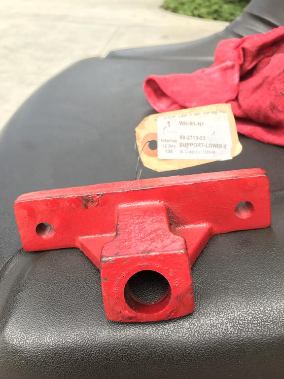

The new lower steering support arrived today.  Fixed the problem.  Steering is as tight as the day it was new!  Appears to be no wear in the vertical steering column - saved me $50.  3488AAF5-DCDC-4135-9851-A80B6EE6FFC1.jpeg.a83be9722816ce5c3c7a9fecde4c1579.jpeg43E70531-1479-44A8-85AA-1A31D60E18F6.jpeg.b9283f3d10d8a7378131bdf794daf578.jpeg39E45D9D-8228-4706-8C4B-C2009C259994.jpeg.77a6f71102dbdb41c1b792418e01a910.jpeg
