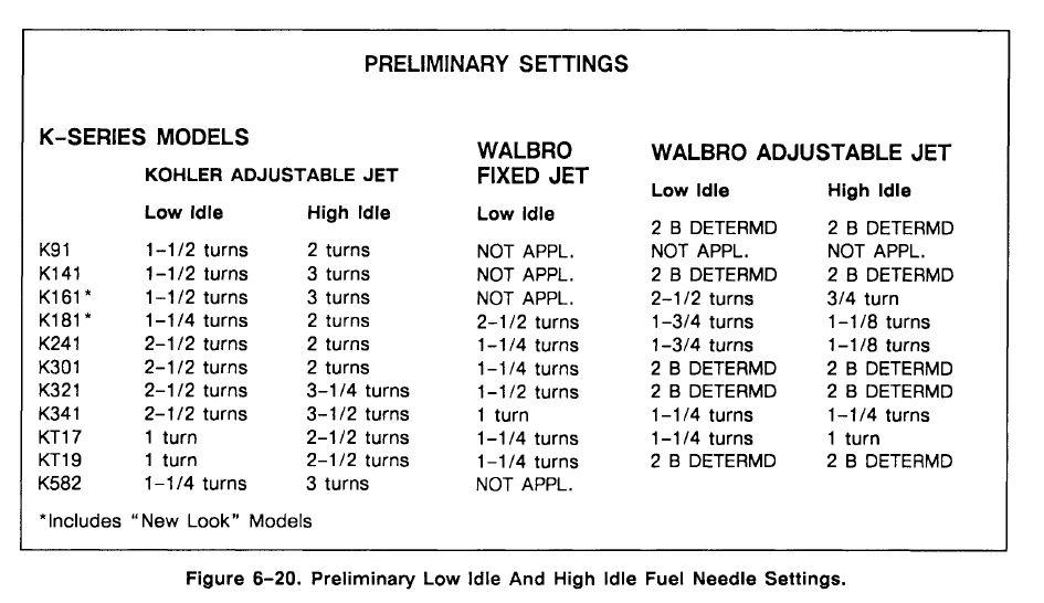

carlosking450 158 #1 Posted September 15, 2019 Hello friends, a while ago I mounted my 702 a carburetor of Isave tractors, I would like to know what its initial setting is, and if you can tell me what the screw is high and low revolutions, thanks Share this post Link to post Share on other sites
carlosking450 158 #2 Posted September 15, 2019 This is my wheel horse 702, just in the absence of adjustments !! 2 2 Share this post Link to post Share on other sites
carlosking450 158 #4 Posted September 15, 2019 for what you tell me is to tighten the screws to the end without forcing them and loosen the turns that you put in the photo? 3 Share this post Link to post Share on other sites
