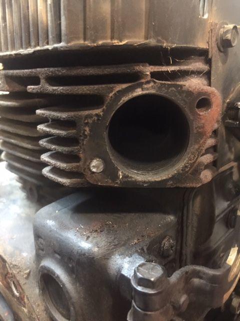

Lagersolut 793 #1 Posted September 14, 2019 (edited) Looking for some advice and numbers - just picked up a 416-8 right off the bat I twisted a bolt head off going in to fix a leak ( no gasket ) . It's a threaded exhaust port ideas on going out of the threads or getting the bolt out ?....I have easy outs but have my doubts they'll turn it. Also I'd like to clean the top end looking for the torque values and tightening sequence reinstalling the head . Edited September 14, 2019 by Lagersolut Share this post Link to post Share on other sites
AMC RULES 37,254 #2 Posted September 14, 2019 Might try welding a nut on the end of that stud. As a by product, the heat from the process may help to release any rust from the threads. Share this post Link to post Share on other sites
Lagersolut 793 #3 Posted September 14, 2019 8 minutes ago, AMC RULES said: Might try welding a nut on the end of that stud. As a by product, the heat from the process may help to release any rust from the threads. It broke off almost flush with the block .. I no sooner had the 1/2 inch open end on it ...pop 1 Share this post Link to post Share on other sites
AMC RULES 37,254 #4 Posted September 14, 2019 (edited) Should be able to still tig one onto it though...then back it out. Edited September 14, 2019 by AMC RULES 1 Share this post Link to post Share on other sites
pfrederi 19,794 #5 Posted September 14, 2019 Head Torque and pattern are in the manual Clean out the threads with a wire brush and use pipe fittings for exhaust. 1 Share this post Link to post Share on other sites
Burnerman 759 #6 Posted September 14, 2019 The only other thing you can do if your unable to weld a nut on it is to drill it out. Level off the broken end of you can with a grinder or file, center punch it and start small and keep increasing the drill size. Also my local hardware store sells left hand drill bits. If you get one of them near the end it may back out. Chase the threads with a tap. OR just thread pipe directly into the block and don’t use the flange mount. 1 Share this post Link to post Share on other sites
clueless 3,347 #7 Posted September 14, 2019 23 minutes ago, pfrederi said: Head Torque and pattern are in the manual Clean out the threads with a wire brush and use pipe fittings for exhaust. put a pipe in it. 1 Share this post Link to post Share on other sites
Lagersolut 793 #8 Posted September 14, 2019 2 hours ago, pfrederi said: Head Torque and pattern are in the manual Clean out the threads with a wire brush and use pipe fittings for exhaust. Thanks Yea I think the easy thing to do is just pipe it out . Share this post Link to post Share on other sites

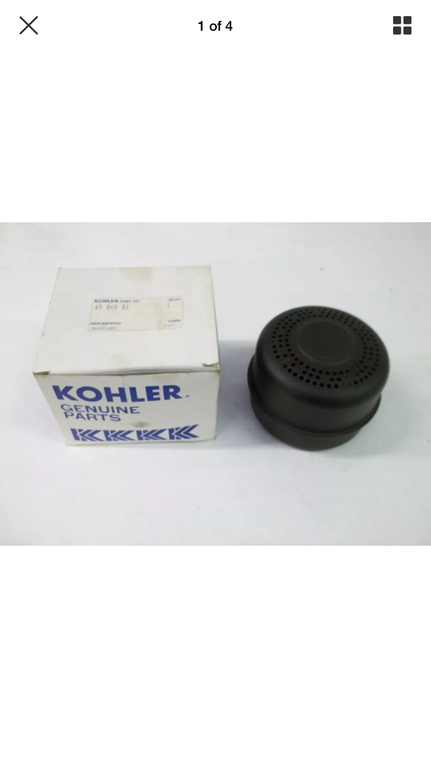

Lagersolut 793 #10 Posted September 14, 2019 (edited) Found this NOS Kohler muffler with 1 1/4 inch NTP threads ... Edited September 15, 2019 by Lagersolut Share this post Link to post Share on other sites
pfrederi 19,794 #11 Posted September 14, 2019 (edited) The K341s for WH all used a reduction fitting from Block to muffler pipe 1-1/4 to 1" Edited September 14, 2019 by pfrederi 2 Share this post Link to post Share on other sites
The Tuul Crib 7,340 #12 Posted September 14, 2019 I agree with welding a nut on the end of the stud . Ive done it countless times with great results. Then l would chase the threads and clean them up, Share this post Link to post Share on other sites
Lagersolut 793 #13 Posted September 15, 2019 3 hours ago, pfrederi said: The K341s for WH all used a reduction fitting from Block to muffler pipe 1-1/4 to 1" Item description says muffler is 1 1/4 going in - would I need to reduce it down to 1" at the block and muffler for the back pressure ? Share this post Link to post Share on other sites
