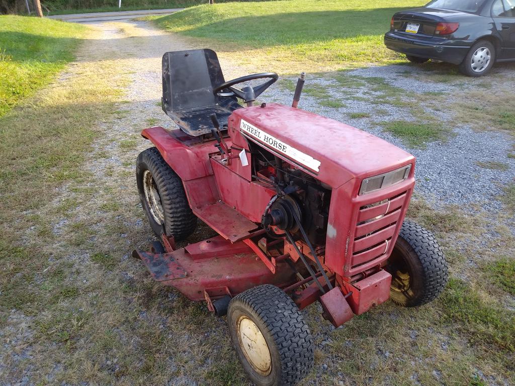

jason dewitt 0 #1 Posted September 11, 2019 hey guys and gals got a wheel horse here its a cross between a c-101 and a c-121 its got a 42 inch deck question is do i use the leaver that adjusts the rear wheels on deck for cut heigth or do i use the knob in the middle of my legs on tractor this is my first horse sorry if stupid question Share this post Link to post Share on other sites

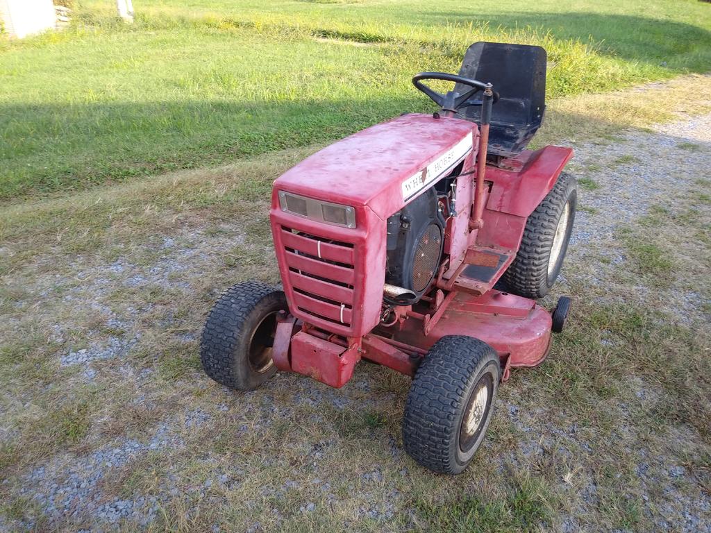

jason dewitt 0 #2 Posted September 11, 2019 (edited) other side lol Edited September 11, 2019 by jason dewitt Share this post Link to post Share on other sites
daveoman1966 3,882 #3 Posted September 11, 2019 The height of cut is set by the small lever near the discharge chute of the mower deck. The BIG lever...on the left side...is to raise and lower the deck. It should lock into the UP position when you pull the lever all the way back. Share this post Link to post Share on other sites

clueless 3,348 #5 Posted September 11, 2019 leaver on deck Share this post Link to post Share on other sites

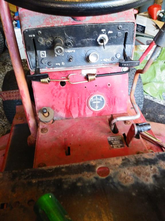

jason dewitt 0 #6 Posted September 11, 2019 ok then what is the knob for by the big leaver is it for when you have a plow or something on it ?? the knob im talking about is on the left side of this pic . Share this post Link to post Share on other sites
Burnerman 759 #7 Posted September 11, 2019 Yes it is used to limit the down travel of the attachment arm. It’s useful for me using my plow. You can limit the down travel of the mower deck but the deck wheels and the attachment frame on the deck are what are designed to control the height of cut. 1 Share this post Link to post Share on other sites
