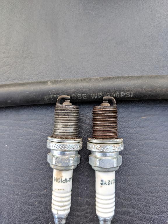

Rxracer 12 #5 Posted September 11, 2019 Just spun a hot compression test after about 5 mins of running, and got 165 on both. Here is a pic of the plugs. Share this post Link to post Share on other sites

Howie 900 #7 Posted September 11, 2019 After a second look at those plugs they don"t look that bad. With 165 on both cylinders I don't think you have a head gasket issue. Share this post Link to post Share on other sites
Rxracer 12 #8 Posted September 11, 2019 Yeah these plugs were changed when I did the full service after getting the mower. So have about 25 hours or so on them. Share this post Link to post Share on other sites
