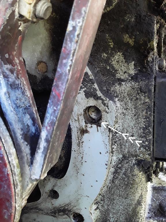

Stike 204 #1 Posted September 9, 2019 I have a k341 in a 1974 D160 that has an oil leak and appears to be coming from the side of the block and was wondering if anyone has come across this and if it is a plug or possibly just accumulating here from another source not sure but thought I'd ask the experts, not a bad leak but want to fix it and clean up before the snow flies and I get lazy for winter. This is on the output shaft side directly behind the points. Share this post Link to post Share on other sites
ol550 844 #2 Posted September 9, 2019 Camshaft rod. Clean with something like brakecleen and fill with silicone. 3 Share this post Link to post Share on other sites
