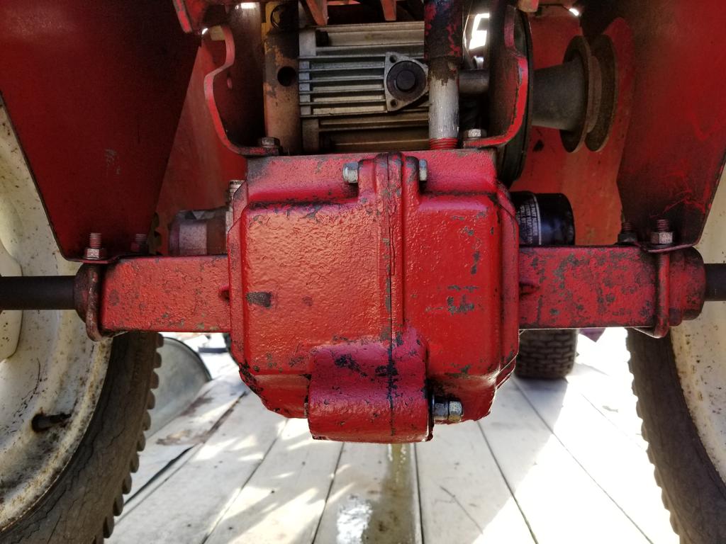

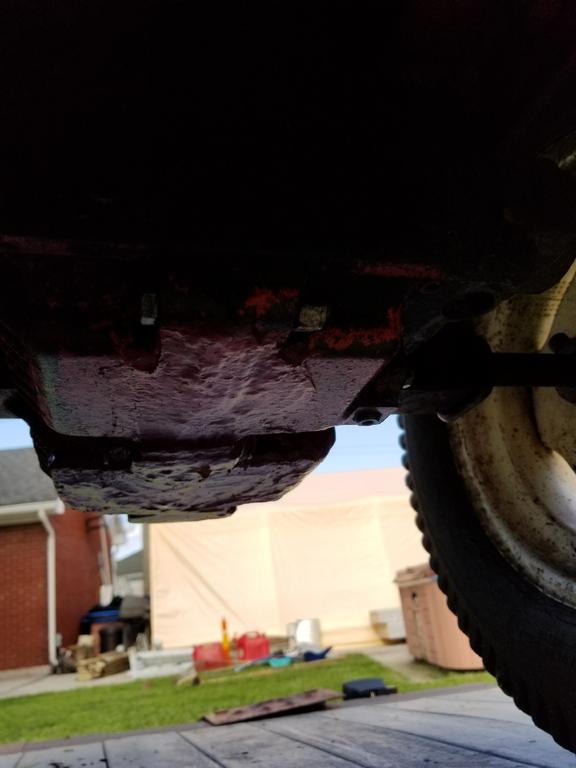

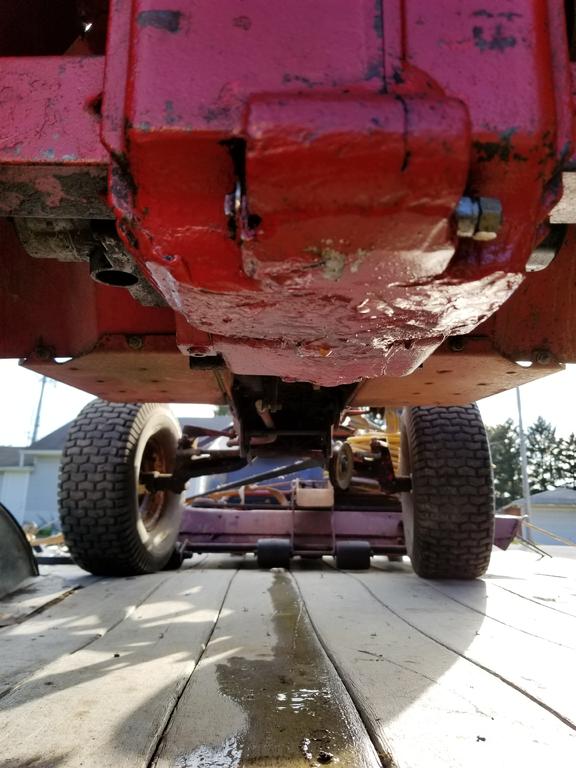

cafoose 3,635 #1 Posted September 9, 2019 The rear is leaking on the GT-14 I just got at auction yesterday. I jacked it up today and when I spin one wheel the other wheel goes in the opposite direction. The tow valve is stuck closed and fluid was dripping from the rear. It seems like mostly at the case gasket. Share this post Link to post Share on other sites

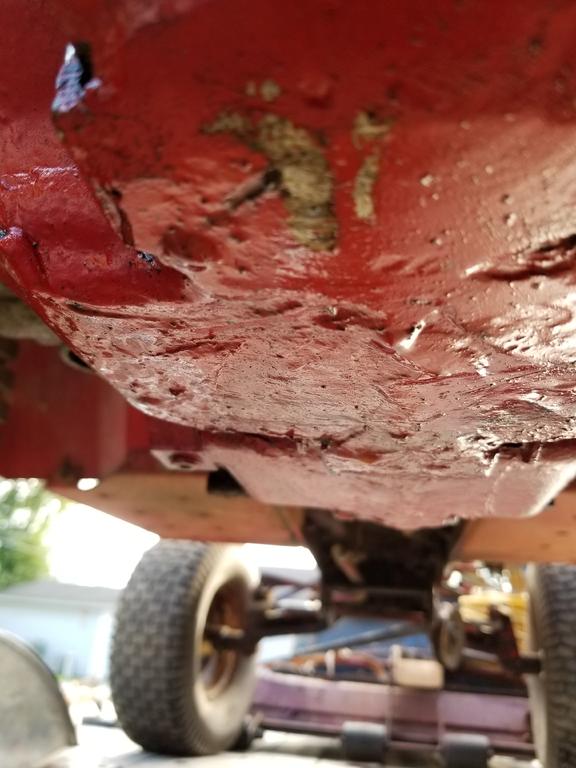

daveoman1966 3,882 #2 Posted September 9, 2019 (edited) As per Pfrederi...I edit my comment. The wheel spins in the SAME direction tells me you have a 10-pinion Limited Slip Differential (LSD). This is absolutely normal. It is designed that if one wheel starts to spin...like in the mud....power is redirected to the other wheel, thereby ensuring that BOTH wheel get power instead of just one wheel as in an 8-pinion differential. ps...If the other wheel spins in the OPPOSITE direction, that means an 8-pinion differential. As to the leak.... Your pic shows that the prior owner tried to stop the fluid leak with bondo or some other exterior adhesive patch. The only SURE CURE is to split the trans case and replace the gasket. Edited September 9, 2019 by daveoman1966 2 Share this post Link to post Share on other sites
953 nut 64,282 #3 Posted September 9, 2019 I got to wonder what is lurking under that patch that was smeared all over the bottom of the case. When you fire up the engine does the hydraulic lift work? Have you attempted to drive the tractor at all? Removing the transmission will require the removal of all the rear sheet metal so you may want to rest it as much as possible while it is together. 1 Share this post Link to post Share on other sites
Ed Kennell 45,026 #4 Posted September 9, 2019 Looks like they also tried to stop the leak by replacing the drawbar hitch with a bolt. 1 Share this post Link to post Share on other sites

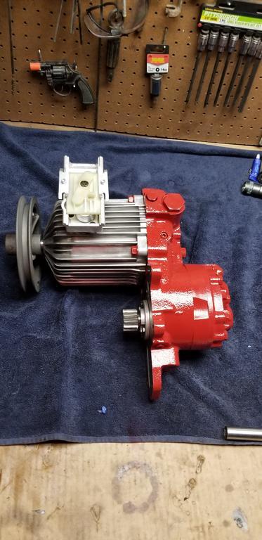

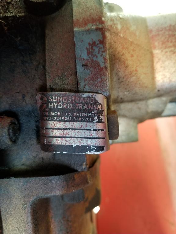

daveoman1966 3,882 #11 Posted September 9, 2019 That Sundstrand tag has 90-1136 on it. It should read 90-2062 as the GT-14 only used that unit. What's more, I can see the HYDRO MOTOR attached to the side which is the 2nd giveaway that you are dealing with a substitute power unit. The GT-14 came with Sundstrand Hydro-Gear 90-2062, as I mentioned. Some prior owner has swapped out the original unit and put the bigger GT-14 Drive Pulley on it.. In any case, that leaky trans will need fixin' ....Tough part is getting sheet metal out of the way, then getting the hubs off. On SOME models, you MAY be able to SPLIT the trans open by removing the 5 or 6 bolts. Spread the cases far apart as possible, then reach in with long wrenches and remove the 4 (8-pinion) or 5 (10-pinion) differential bolts. Then you can remove the internal clips and pull axles out...with hub still on. 1 1 Share this post Link to post Share on other sites
cafoose 3,635 #12 Posted September 9, 2019 51 minutes ago, daveoman1966 said: Some prior owner has swapped out the original unit and put the bigger GT-14 Drive Pulley on it.. I did see that it looks as if someone was messing with it. The hydro seems very clean for the age and the paint seems newer. I have another GT-14 I can use for parts that I got last month for $2 at another auction. 1 Share this post Link to post Share on other sites
