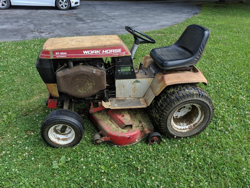

ktowndave 5 #1 Posted September 7, 2019 I am going to do a partial possible full restoration and have a few questions and looking some parts. My tractor is a gray GT 1800, 48" side discharge deck, the original deck was a 36" rear discharge. Questions: What is the actual color of gray and red? What size of mowing blades for a 48" deck? Will spindles from a 36 or 42" deck fit on a 48" deck? Is there any way to refresh faded decals? Don't really want to purchase a set of new decals. Looking for: A battery box and the hold downs. Deck wheels and rollers. Thanks for any answers, Dave Share this post Link to post Share on other sites

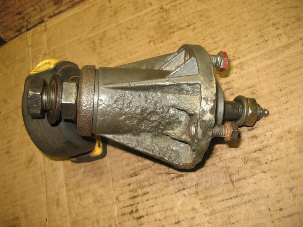

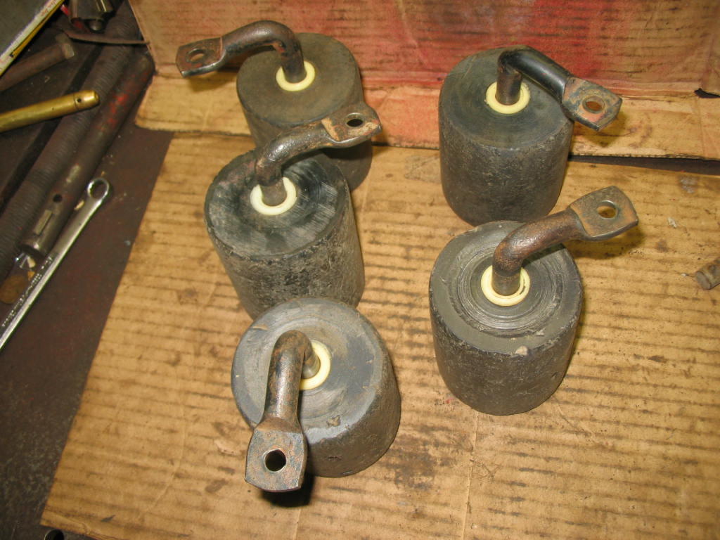

daveoman1966 3,882 #5 Posted September 7, 2019 Spindles for a 42 and / or 48 are the same....top pulleys are different dia and bore size. I have one spindles on Ebay to fit the 42 or 48. Spindles for 36" are much shorter. Also have 7 or 8 sets of Anti-scalp rollers...with mounting bar....Very good cond. These have NEW nylon bushings / inserts. Can probably find s matched set of Gage wheels too.... For more pics and details....send request to me at: My email is: daveoman@windstream.net Share this post Link to post Share on other sites
AHenry014 128 #6 Posted September 9, 2019 (edited) If that were mine, i would be trying to save the patina! Being a Work Horse, it is supposed to be grey. Often confused for primer with stickers. I would be restoring everything around it like the engine tins/covers, clean up the wheels, clean and paint the deck. Some matte clear over the tins once cleaned would preserve the current look, which i really like, but to each their own. Look into the "comet wash". Id bet the color would come back more than you think! Edited September 9, 2019 by AHenry014 Share this post Link to post Share on other sites
