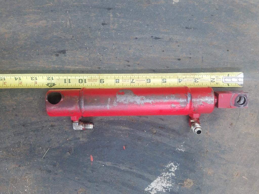

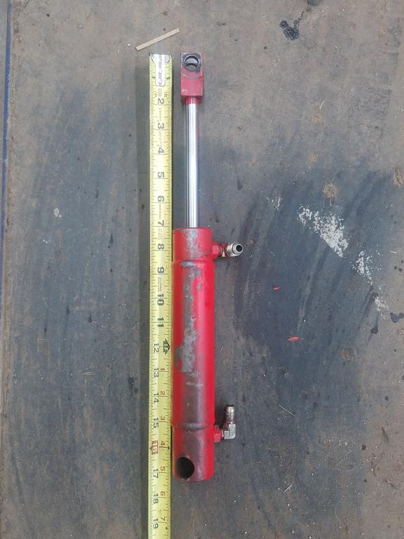

hp73vettes 6 #5 Posted September 5, 2019 Hope these help. It's 10 7/8 closed and 15 7/8 open measured center to center of pin holes Share this post Link to post Share on other sites
The Tuul Crib 7,340 #6 Posted September 5, 2019 (edited) 2 minutes ago, hp73vettes said: Hope these help. It's 10 7/8 closed and 15 7/8 open measured center to center of pin holes If you dont have any luck l do have one pm me Edited September 5, 2019 by The Tool Crib Share this post Link to post Share on other sites

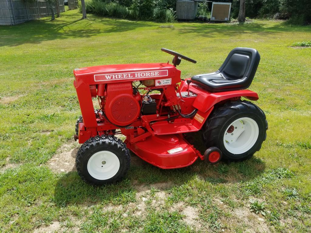

hp73vettes 6 #8 Posted September 5, 2019 Figured I'd post a pic of it 5 Share this post Link to post Share on other sites

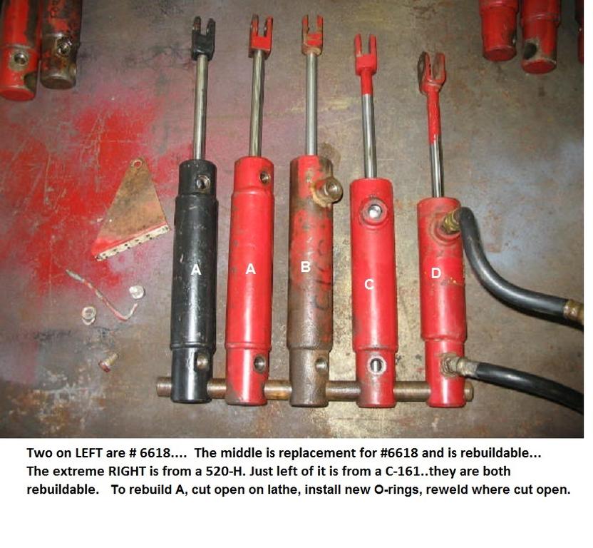

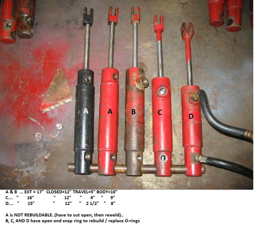

daveoman1966 3,882 #9 Posted September 5, 2019 (edited) I had the same issue with my 75 C-160. The OEM cylinger is # 6618 (A below). Found one that is rebuildable from a 77 C-=160. and it is like 'B' in this pic...part # 105254 but it is marked discontinued. Cyl 'C" is this pic is a bit shorter and MAY not suit your need. It is from a C=141 (I think)... Cyl 'D' is definitely too short as it is frm a 520-H. Edited September 6, 2019 by daveoman1966 2 Share this post Link to post Share on other sites

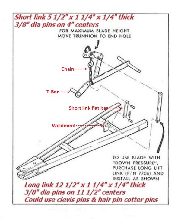

hp73vettes 6 #13 Posted September 6, 2019 I have another question. To set up a plow. Should I use the pivot point where the plow attaches to the front of the tractor or lift it from the middle of the plow with the mower lift arm. I only tried to set the plow up using the pivot point in front . It hooks up in the rear and where the mule drive was. But not sure which method to use for lifting it Share this post Link to post Share on other sites
daveoman1966 3,882 #14 Posted September 6, 2019 Once hooked to the rear Tach-o-Matic hitch, the front MULE drive removed, the lift point of the dozser blade is like this...usually with a chain...but a lift bar can also be used as an alternative. A long flat bar can also be used which will allow DOWN pressure... Share this post Link to post Share on other sites
hp73vettes 6 #15 Posted September 6, 2019 thanks again. the plow set up that i purchased had a link and pivot point that went where the mule drive was mounted. it must of been for a manual lift. i was trying to set up a rod that went to the deck lift arm. it worked but didnt have much lift height. i see by your pic it can be lifted from the middle. ill have to weld up a bracket at mid point of plow frame like the one in the pic you posted. and i will try the washer and oring idea while i search for a lift cylinder thats rebuildable.... thanks again for your help. Share this post Link to post Share on other sites
ZXT 2,401 #16 Posted September 6, 2019 4 hours ago, hp73vettes said: Figured I'd post a pic of it Now that is one beautiful tractor! Did you restore it yourself or did you buy it that way? If the mechanical parts of the tractor are in as good of shape as the rest of the tractor looks, then you have a tractor that will last you a lifetime. Needless to say, I'm a bit jealous! What's the lever that's sticking up in front of the seat? My c160 doesn't have it. Share this post Link to post Share on other sites
hp73vettes 6 #17 Posted September 6, 2019 thank you for the kind words. i did the restore myself . the lever in front of the seat is to release the seat pan to gain access to hydro fill tube / box under seat Share this post Link to post Share on other sites
daveoman1966 3,882 #18 Posted September 6, 2019 (edited) Not to burst any bubble or to be picayune, but the Motion Control Lever shown on this tractor is a trademark of the 1973 'No-Name' year. The Motion Lever is between your knees which is a little awkward. I know that because I owned a 1973 12hp Automatic of exactly same setup...it was model 1-0465. Given that distinction, your tractor decals would be simply "16hp Automatic" (instead of '"C-160") and the model number would be 1-0440. In 1974 the official C-160 was born and the Motion Lever was changed to a tall vertical arm on the Right side...approx the height of the steering wheel...making it much easier to control fwd/rev directions and speed. Just thought I'd throw that out there. Edited September 6, 2019 by daveoman1966 Share this post Link to post Share on other sites
hp73vettes 6 #19 Posted September 6, 2019 thats good info to know. i only replaced what was previously on the machine. no bubbles popped here... Share this post Link to post Share on other sites
daveoman1966 3,882 #20 Posted September 6, 2019 15 minutes ago, hp73vettes said: thats good info to know. i only replaced what was previously on the machine. no bubbles popped here... Regardless....thats a VERY nice machine. Tractors like that cause addictions, ya know..... lol 1 Share this post Link to post Share on other sites
