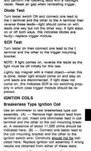

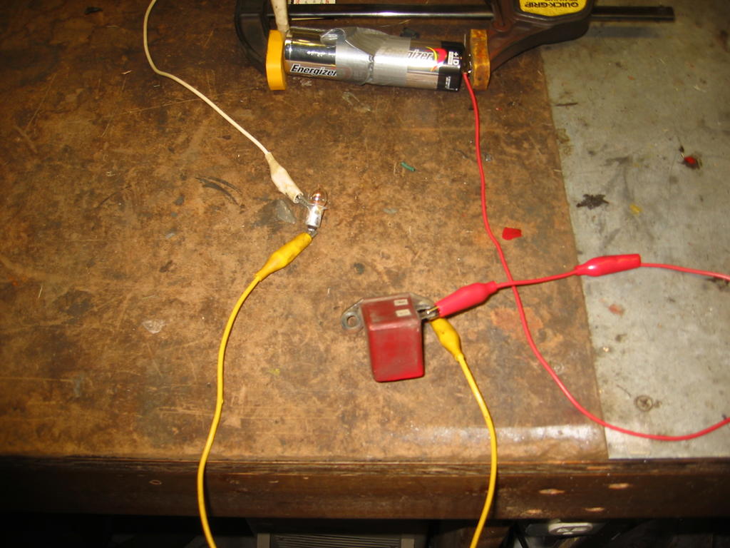

pfrederi 19,810 #1 Posted September 4, 2019 There have been a couple question recently about how to test the trigger in a Breakerless iginiton system. Working triggesr are worth money so it is best to test before you discard. Manual calls for a flashlight tester which I doubt many of us have. Here are a couple of pictures to show how you can easily make one up. All you need is a couple batteries and old incandescent flashlight bulb (I use a PR2) and some alligator clip jumper wires. First picture show hook up to test the diodes second the switch. 3 2 1 Share this post Link to post Share on other sites
