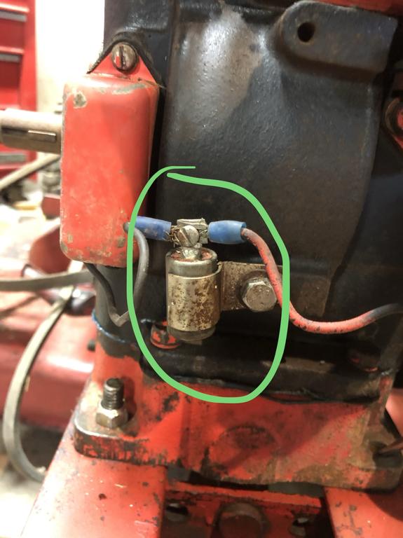

Stormin 9,988 #26 Posted September 12, 2019 49 minutes ago, ebinmaine said: That's your ignition condenser Somebody else will have to tell you what it does... Something to do with dampening high voltage pulses... Eric's more or less correct. It reduces the spark at the points to reduce burning and pitting. 1 Share this post Link to post Share on other sites
Fuzz 20 #27 Posted September 12, 2019 35 minutes ago, Stormin said: Eric's more or less correct. It reduces the spark at the points to reduce burning and pitting. So would that cause it to not get any spark? That’s where I’m at now. However if I bypassed it and connected the wires together I should get spark if the condenser was the issue right? 1 Share this post Link to post Share on other sites
Stormin 9,988 #28 Posted September 12, 2019 4 minutes ago, Fuzz said: So would that cause it to not get any spark? That’s where I’m at now. However if I bypassed it and connected the wires together I should get spark if the condenser was the issue right? If it's faulty, yes. As for your second question. Personally I wouldn't. I'd get another condenser. Cheap enough and if the fault isn't the condenser, you'll have a spare. 1 Share this post Link to post Share on other sites
ebinmaine 81,150 #29 Posted September 12, 2019 3 hours ago, Fuzz said: removing the flywheel to clean the points and magneto now 4 hours ago, Fuzz said: Hey guys anyone know what this piece is? It’s off the kohler K181T No need to remove the flywheel Fuzz. I don't think that has a magneto and your points are behind the red cover that is next to the condenser. 3 Share this post Link to post Share on other sites

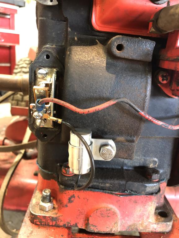

Fuzz 20 #37 Posted September 13, 2019 (edited) New condenser and points. Still no spark. Suggestions? The red wire hooked to the old condenser. Is it possible it’s the wrong one and it needs to be hooked to the condenser not the points? Edited September 13, 2019 by Fuzz Share this post Link to post Share on other sites

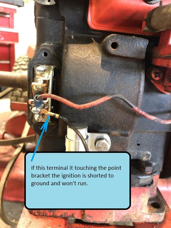

pfrederi 21,311 #46 Posted September 13, 2019 (edited) I think we should note this is a pull start Engine it has a magneto under the flywheel with points and condenser on the block as shown in his pictures. there is no external can shaped ignition coil. as a Mag system there has to be a kill wire (or a button in the points cover) to stop it. Make sure the concertgoer for the condenser is not touching the points body hard to tell in teh picture but hat would kill the spak. Edited September 13, 2019 by pfrederi 1 Share this post Link to post Share on other sites

pfrederi 21,311 #48 Posted September 13, 2019 (edited) 8 minutes ago, Fuzz said: All of that tested fine. Still no spark... does the on/off switch have to be hooked up? Where does that wire hook to? The on off is a toggle switch on the hood stand panel. The kill wire goes to that and the switch grounds the wire when in the off position.should be grounded. The other end is hooked to teh condenser lead (or points wire which ever is easier. Check and make sour your d=condeser wire connecter is not touching the body of the points In you r first picture the black wire looks to be your kill wire. It is missing in the second pictur. Edited September 13, 2019 by pfrederi Share this post Link to post Share on other sites

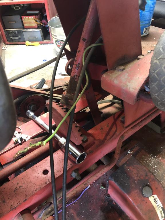

Fuzz 20 #50 Posted September 13, 2019 Here’s the wire for the on/off switch. It’s not connected to anything. I wired it up just for the hell of it to the points. Nothing.... with a spark plug tester I get a very faint light on it. If I take the plug out and set it on the block, no spark. Everything tests fine with the ohmmeter. Share this post Link to post Share on other sites
