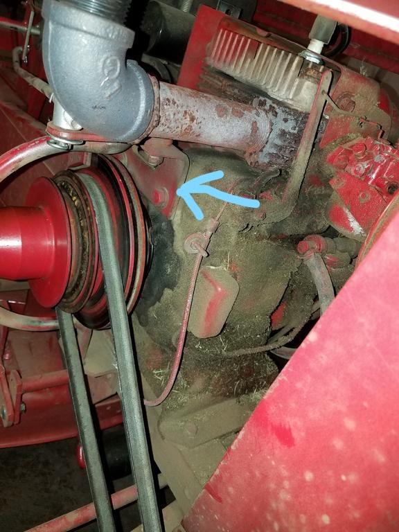

pfrederi 20,664 #8 Posted September 3, 2019 The 8 hp engine you had uses a different Engine bracket (blue arrow) for the PTO (104732) than the big block models (104729) That may be your problem. Share this post Link to post Share on other sites
Goldnboy 1,117 #9 Posted September 3, 2019 1 hour ago, pfrederi said: The 8 hp engine you had uses a different Engine bracket (blue arrow) for the PTO (104732) than the big block models (104729) That may be your problem. I had already planned for the different Bracket size. Share this post Link to post Share on other sites
