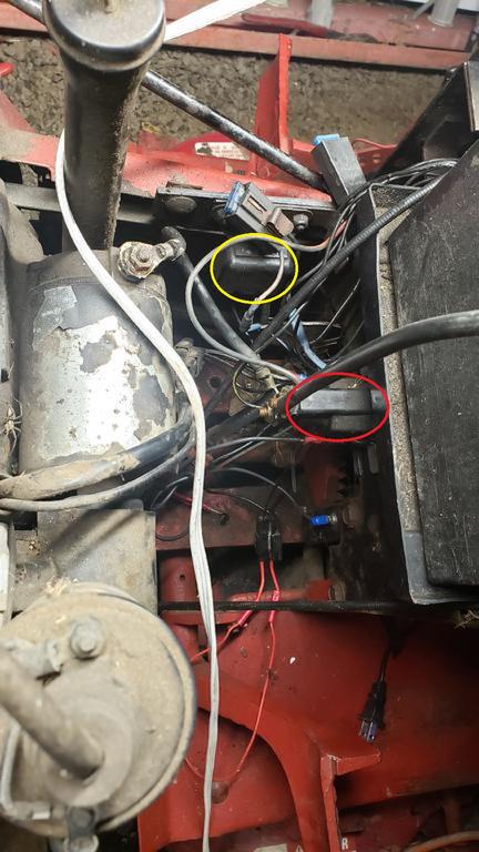

gwest_ca-(File Mod) 11,990 #8 Posted September 3, 2019 Two of the wires at the relay should be light blue and purple. If they are there pull them off and join them. Circled the low oil relay yellow. Starter solenoid red. There should be one end of the purple wire on a small terminal on the solenoid. If they are not there look for the light blue going back to the clutch pedal switch. I think your's is on the right side next to the drive belt idler pulley. You should be able to see the back of the switch looking through the slots in the flat panel the shifter travels through. About the 2nd gear position. More questions welcomed. Garry Share this post Link to post Share on other sites

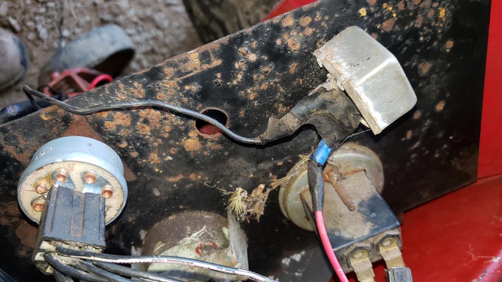

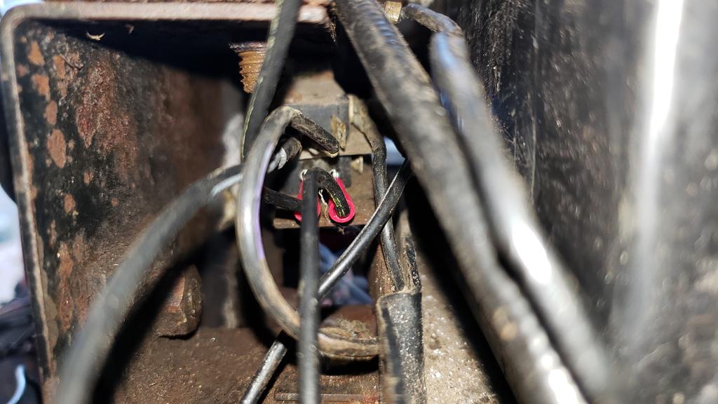

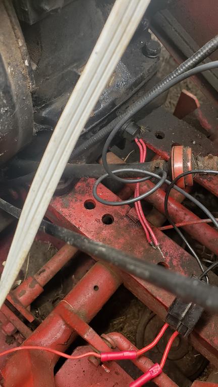

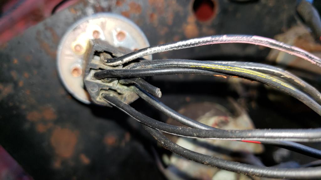

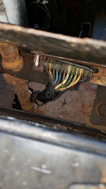

mark in ny 27 #9 Posted September 3, 2019 Ok so trying to eliminate the oil switch i now have nothing. When powered up the seat switch works as it should with voltage and the ignition works as the diagram for starting and running connectors. Now what ive found out is that the test switch was used as a start button with the key which confirms it turning over yesterday. There is a red power wire from that button to the starter solenoid and a wire that was connected to the low oil switch with a twin post connector. Im feeling im gonna have to completely rewire it but Im gonna need some help sorting out wires if you can haha. i have one wire cut at the ignition switch and wires cut at the main circuit to what im assuming was the test switch. I have some pictures showing what i mean if im not quite describing it right. Share this post Link to post Share on other sites

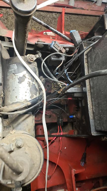

mark in ny 27 #10 Posted September 4, 2019 also this is the relay for the seat switch one has a double terminal on it on the top relay and nothing else. Thats the one that im assuming goes to the starter. So i tie the oil safety switch together and plug into that terminal then the open terminal i run to the starter? The safety switch and seat switch go on the double terminal or seperate? this is confusing why are people such hacks when it comes to this kinda stuff. Share this post Link to post Share on other sites
gwest_ca-(File Mod) 11,990 #11 Posted September 4, 2019 23 minutes ago, mark in ny said: also this is the relay for the seat switch one has a double terminal on it on the top relay and nothing else. Thats the one that im assuming goes to the starter. So i tie the oil safety switch together and plug into that terminal then the open terminal i run to the starter? The safety switch and seat switch go on the double terminal or seperate? this is confusing why are people such hacks when it comes to this kinda stuff. These are the pto switches - one for the starter circuit and one for the ignition. Click on the picture. Here is a file on the ignition switch. Click on the picture and again on the next page to see the terminals identified. Garry Share this post Link to post Share on other sites

peter lena 9,732 #16 Posted September 6, 2019 mark, is your steering column sloppy ? that picture showing the wear and rust indicates it is. now that you have it running , doing a thorough baseline service should be the next issue . all oils, engine and trans , replace transmission shift boot , to stop moisture entry, changing oils after thoroughly warming up units works best. grease chassis and lubricate any and all friction points. i am just adding this , because if you plan to get a snow thrower , you will be loading up the engine and drive train , give it the service BEFORE the work. SEAFOAM GAS TREATMENT , will help out your carburetor, along with , new fuel lines and gas filter. we have all been through similar problems, but a baseline service will let you know what you have , and make regular checks , routine . good luck with it, let us know, pete Share this post Link to post Share on other sites
mark in ny 27 #17 Posted October 1, 2019 On 9/6/2019 at 8:32 AM, peter lena said: mark, is your steering column sloppy ? that picture showing the wear and rust indicates it is. now that you have it running , doing a thorough baseline service should be the next issue . all oils, engine and trans , replace transmission shift boot , to stop moisture entry, changing oils after thoroughly warming up units works best. grease chassis and lubricate any and all friction points. i am just adding this , because if you plan to get a snow thrower , you will be loading up the engine and drive train , give it the service BEFORE the work. SEAFOAM GAS TREATMENT , will help out your carburetor, along with , new fuel lines and gas filter. we have all been through similar problems, but a baseline service will let you know what you have , and make regular checks , routine . good luck with it, let us know, pete I'm starting to take a look at some of the minor issues. New battery fires right up and runs amazing. Trying to make sure I have all the parts I need for the snowblower before I place a order for the shifter boot that was dry rotted. I also dont have brakes haha but the clutch works temporarily. Also I'm looking into the steering slop because the console is cracked, I'm not sure what I'm gonna do. Been searching alot for a replacement console with little luck. 1 Share this post Link to post Share on other sites
