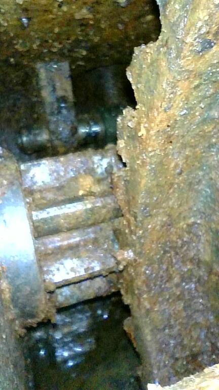

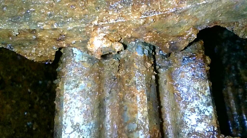

Handy Don 17,571 #1953 Posted January 13, 2025 (edited) 1 hour ago, ebinmaine said: Would it be worth buying a cheap "camera on a stick" type scope to peer down in there? Or should I just split the engine anyway? Too bad that’s such a biggie. A Christmas present was a commercial endoscope--I could bring it to our meetup. First practical use was to check inside a rescued Suburban transaxle via the oil fill hole (I dipped it with a dowel first to be sure there was no oil in there 😄). Kinda crowded in there and I’m new with the gadget so I didn’t probe too deep but this is the final drive on the brake shaft and the bull gear on the differential. So pretty rusty, but not irretrievably bad! Edited January 13, 2025 by Handy Don 5 Share this post Link to post Share on other sites
