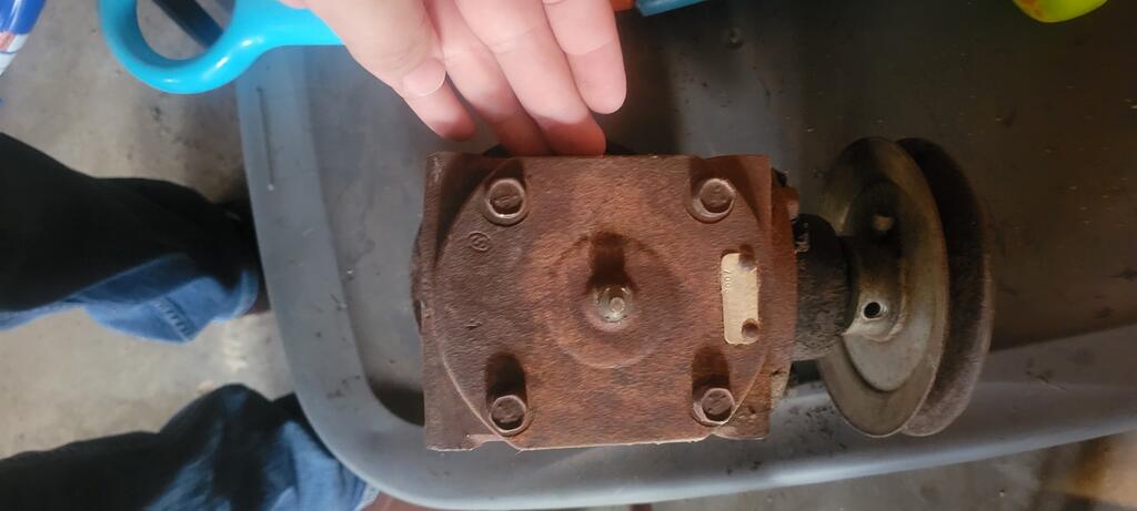

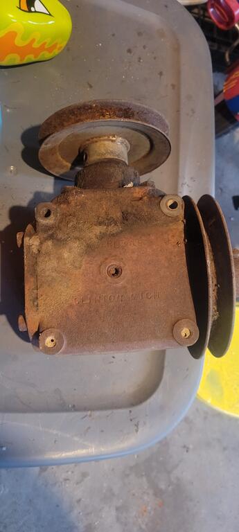

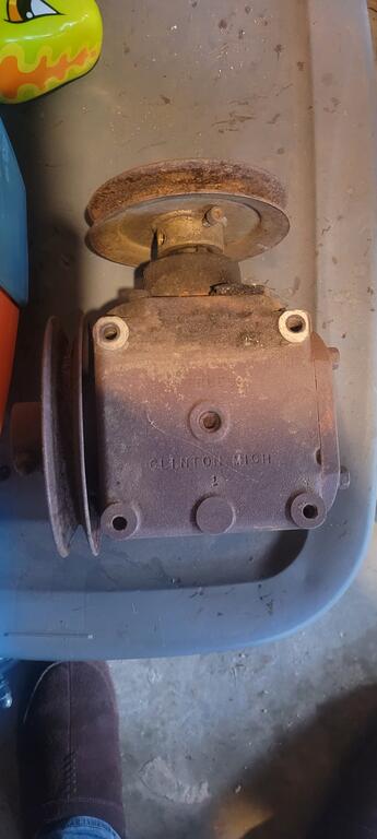

ebinmaine 80,719 #1738 Posted November 7, 2022 7 minutes ago, Oldskool said: Eric must be doing Eric stuff. He hasn't chimed in. I'm here bubba. Hadda let the dog out to do dog stuff. 'mongst other stuff. 1 hour ago, rjg854 said: Cough cough cough cough It's a little cloudy in here Eric, you blew the dust off this thread. You folks might wanna go dose up on allergy meds. 1 hour ago, Oldskool said: What up? @Snoopy11 Don are correct. If'n you go waaaaaay back in this 70 page thread you'll see I been thinkifying on which way to plop the powerplant down on this here rig. I do like the traditional longitudinal way such as most Horses and I'm sure it would be fine. Mostly. I'd settled on doing that even though the left side would have been SOME heavier. Then.... @OldWorkHorse Steve and I were blabbering about tractors and such when he mentioned some gobbledygook about a gear box. Now hold up a minute!!!! Steve's fairly sure the above mentioned piece has a 4" pulley on one side and 5" on the other. We believe they could be swapped but obviously could be replaced to accommodate a friendly drive gear ratio. So set the engine down with the rear facing the driver. Belt or chain direct to this box. This box would then be the connection to the clutch and transmission. 1 Share this post Link to post Share on other sites
Oldskool 6,678 #1739 Posted November 7, 2022 What size shafts does that have? Share this post Link to post Share on other sites
ebinmaine 80,719 #1740 Posted November 8, 2022 22 minutes ago, Oldskool said: What size shafts does that have? Should be either ½" or ¾". I haven't decoded it yet. Should be a 20 HP rated box. My engine is 23 HP but will be dialed down in RPM along with me normally running about 70 to 80% throttle. Rotation direction will need to be determined yet... 1 Share this post Link to post Share on other sites

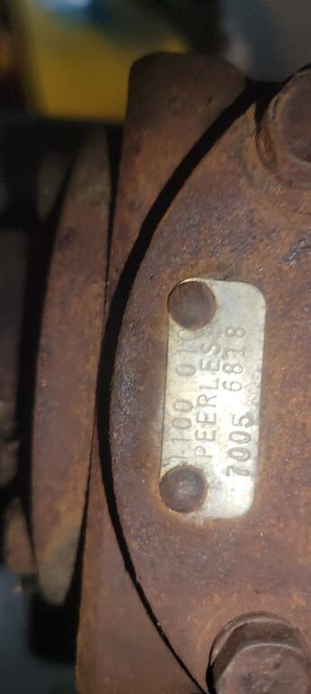

Oldskool 6,678 #1741 Posted November 8, 2022 Have you seen a Peerless 700 series gearbox? About the same size. They were 90 degrees 3 4, or 5 speed with reverse. One of those coupled with the WH 8speed would be quite an animal with the correct pulley sizes. A gear ratio for every occasion, and then some. 5 Share this post Link to post Share on other sites
ebinmaine 80,719 #1742 Posted November 8, 2022 1 minute ago, Oldskool said: Have you seen a Peerless 700 series gearbox? About the same size. They were 90 degrees 3 4, or 5 speed with reverse. One of those coupled with the WH 8speed would be quite an animal with the correct pulley sizes. A gear ratio for every occasion, and then some. I've seen on the YouTubes folks build other homemade tractors using a similar setup. Interesting idea there. 3 Share this post Link to post Share on other sites
Oldskool 6,678 #1743 Posted November 8, 2022 It's a popular gearbox for sure. Alot of parts available for those. 2 Share this post Link to post Share on other sites
