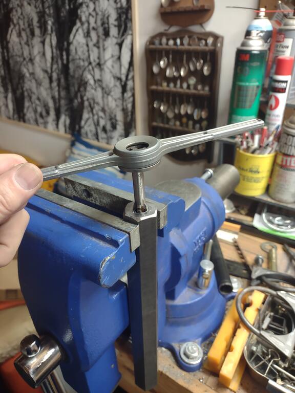

ebinmaine 81,282 #1287 Posted November 11, 2021 10 minutes ago, Lee1977 said: Did you get the tie rod "weights" finished. Just gotta thread one hole and drill the spindles. 3 Share this post Link to post Share on other sites

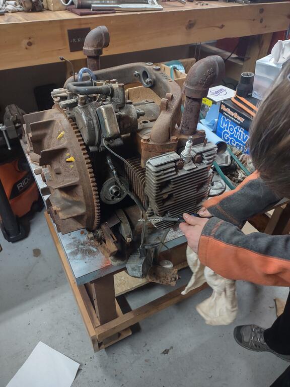

Stormin 9,988 #1288 Posted November 12, 2021 Anyone else notice WHO is doing the cleaning on that engine? 2 2 Share this post Link to post Share on other sites
slim67 2,825 #1289 Posted November 12, 2021 23 minutes ago, Stormin said: Anyone else notice WHO is doing the cleaning on that engine? Not Eric😀 1 Share this post Link to post Share on other sites

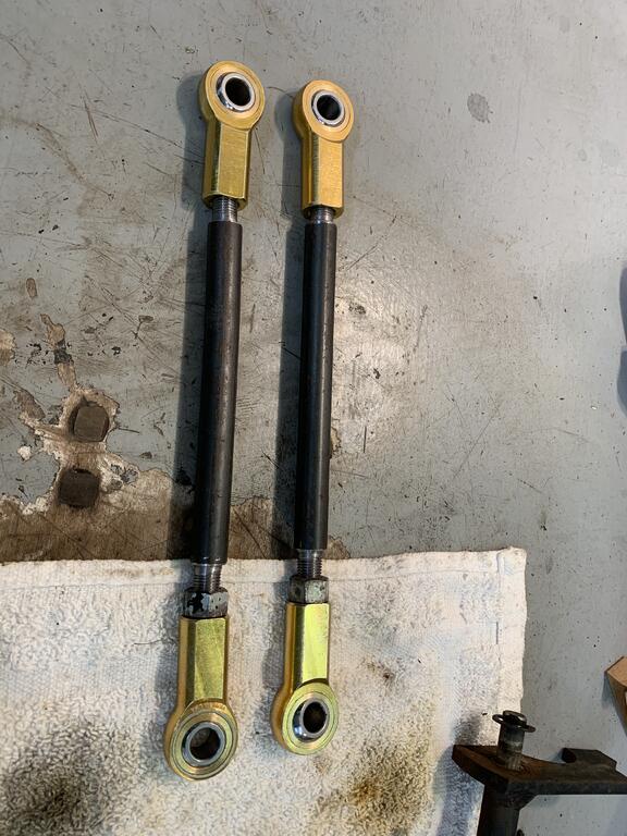

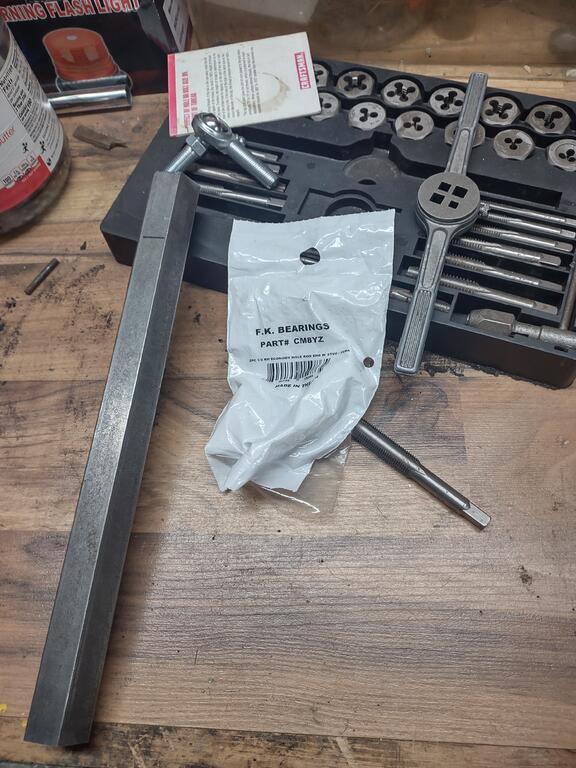

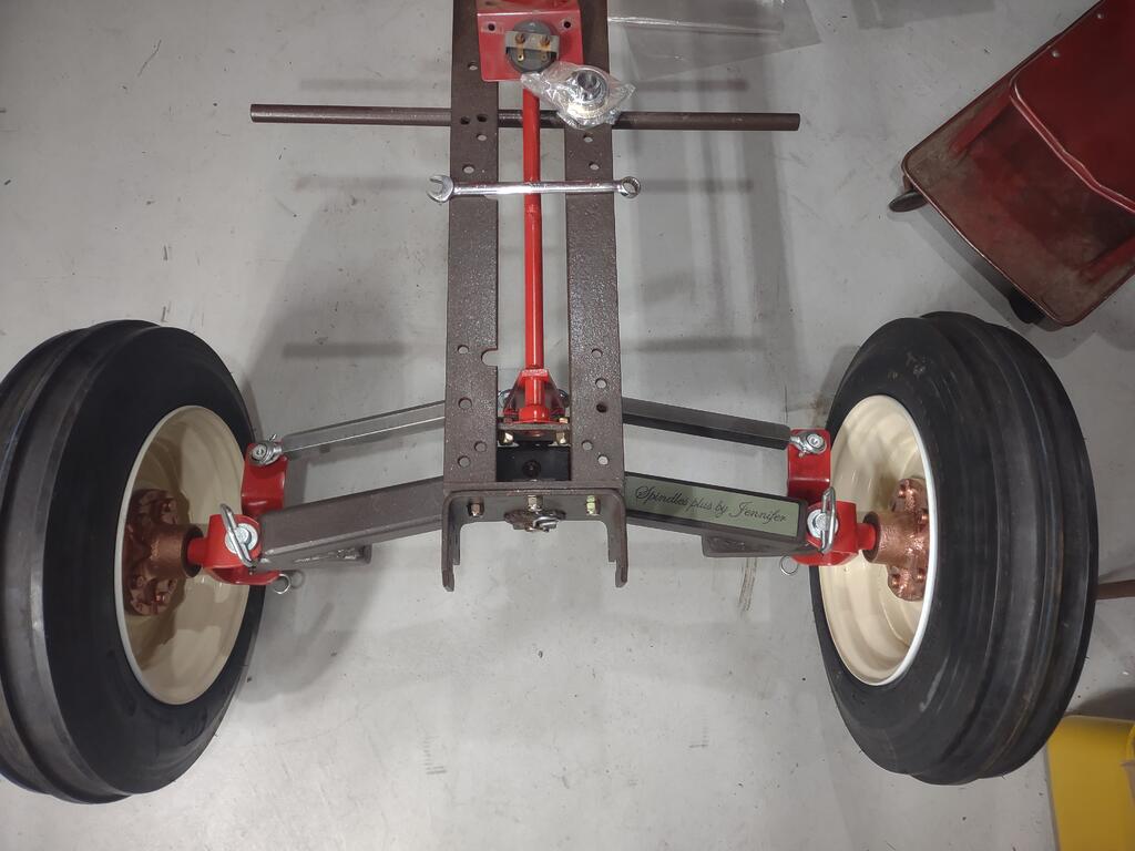

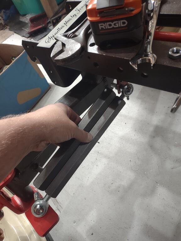

ebinmaine 81,282 #1290 Posted November 12, 2021 Making up the other tie rod today. 1 3 Share this post Link to post Share on other sites
Horse Newbie 7,405 #1291 Posted November 13, 2021 (edited) 5 hours ago, ebinmaine said: Making up the other tie rod today. You mean I could have got a ball joint with a stud on the end that bolts to spindle arm, and female threads on the end that goes on the tie rod ? I’ m gonna need to put a bolt to hold my ends to spindle arms... And to the doo hickey that swings left to right to turn the wheels... Edited November 13, 2021 by Horse Newbie 1 Share this post Link to post Share on other sites
ebinmaine 81,282 #1292 Posted November 13, 2021 1 hour ago, Horse Newbie said: You mean I could have got a ball joint with a stud on the end that bolts to spindle arm, and female threads on the of end ?... Yessir. McMaster Carr has all kinds of neat and different stuff. 1 Share this post Link to post Share on other sites

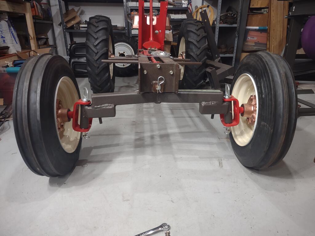

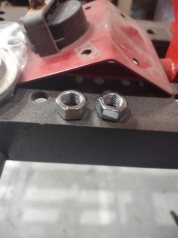

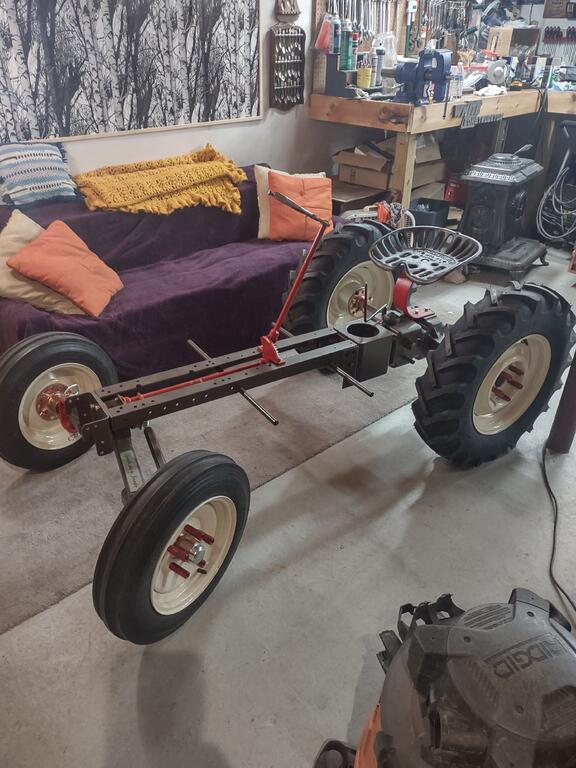

ebinmaine 81,282 #1293 Posted November 13, 2021 I finished up the other tie rod by cutting off the end to the correct length. Drilled it and tapped it. I had no 1/2-20 nuts around so I drilled and tapped a couple 7/16 just to keep things tight for the time being. Installed both the rods after measuring about 86 times. And the Colossus beast is a rolling chassis. 1 4 Share this post Link to post Share on other sites

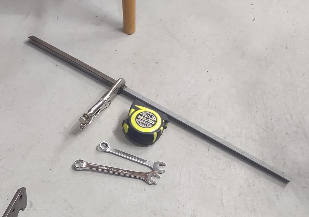

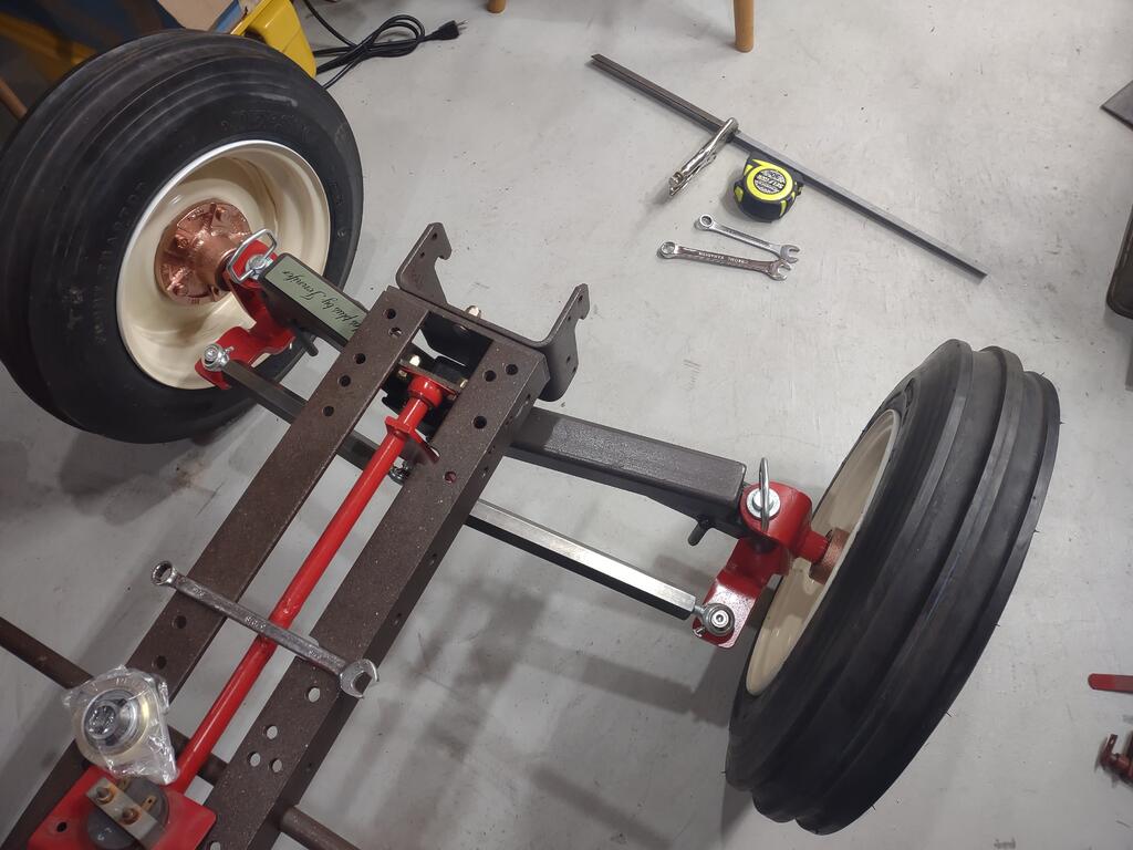

Horse Newbie 7,405 #1294 Posted November 13, 2021 8 minutes ago, ebinmaine said: Installed both the rods after measuring about 86 times How much “toe-in you gonna have ?... and how do you figure/measure that ? Share this post Link to post Share on other sites
ebinmaine 81,282 #1295 Posted November 13, 2021 14 minutes ago, Horse Newbie said: How much “toe-in you gonna have ?... and how do you figure/measure that ? Tow-in. Front to back will be at least 1/4". I also added a bunch of tilt to the spindles when I designed them. The tops of the tires are tilted OUT about 1.25 inches compared to the bottom. This supposedly gives a better grab to the outside steering tire in turns. 2 Share this post Link to post Share on other sites
8ntruck 9,420 #1296 Posted November 13, 2021 How much caster angle did you build in? Share this post Link to post Share on other sites
Horse Newbie 7,405 #1297 Posted November 13, 2021 (edited) 13 minutes ago, ebinmaine said: Tow-in. Front to back will be at least 1/4". So when I set my spindles in place I need to measure across the front and back of the tire/wheel and if the front is 25”,then the back needs to be 25-1/4” ? Edited November 13, 2021 by Horse Newbie 1 Share this post Link to post Share on other sites
ebinmaine 81,282 #1298 Posted November 13, 2021 6 minutes ago, 8ntruck said: How much caster angle did you build in? The axle was a home built I lengthened. It's around zero. I didn't change that. Share this post Link to post Share on other sites
ebinmaine 81,282 #1299 Posted November 13, 2021 8 minutes ago, Horse Newbie said: So when I set my spindles in place I need to measure across the front and back of the tire/wheel and if the front is 25”,then the back needs to be 25-1/4” ? Yepp. See the pic below. Use 2 flat objects that can be clamped together. I had metal rulers handy.. Hold them halfway up the front of the WHEELS so they just lightly touch each wheel and clamp them in place. Now keeping them clamped see what the distance is from one wheel to the other at the same approximate height at the back of the rim. The difference is your toe-in. 2 Share this post Link to post Share on other sites
