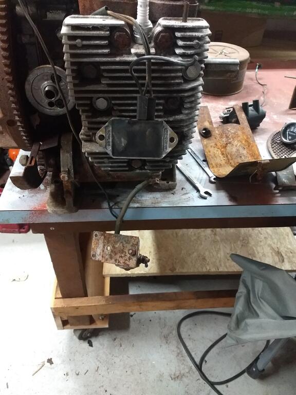

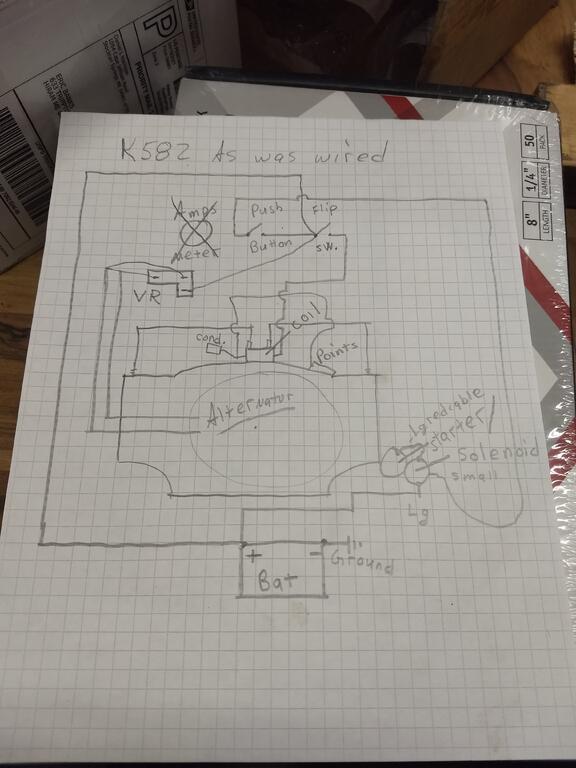

ebinmaine 80,424 #1211 Posted April 23, 2021 Drew up a quick schematic for the engine electric system as it was when I got it. Snipped the wires off and removed some more parts from the engine. 5 3 1 Share this post Link to post Share on other sites
Pullstart 71,142 #1212 Posted April 23, 2021 I see your voltage regulator is feeding the + side of the ignition switch. I’ve been told (though I wired it like yours) that a VR might possibly could have a parasitic draw if left constant to the battery. If you’re harness building, it wouldn’t hurt to run it to the flipped side of the switch... 1 1 Share this post Link to post Share on other sites
ebinmaine 80,424 #1213 Posted April 23, 2021 56 minutes ago, pullstart said: I see your voltage regulator is feeding the + side of the ignition switch. I’ve been told (though I wired it like yours) that a VR might possibly could have a parasitic draw if left constant to the battery. If you’re harness building, it wouldn’t hurt to run it to the flipped side of the switch... That's a valid point and thank you for the reminder. 1 Share this post Link to post Share on other sites

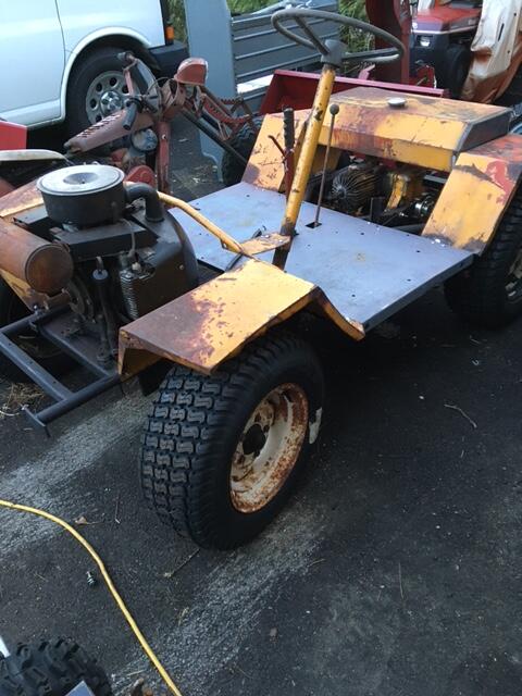

wallfish 20,532 #1224 Posted September 27, 2021 Hey Eric It's been a while since reading this thread and didn't go back through it all but curious what you're doing for a gas tank. Just had a K532 on the Roof 60 tractor running again this weekend and that thing can suck all the gas outta a small 3/4 gallon tank in no time! That's mostly idling to mid rpm range so full speed should really evaporate some fuel. Now I see why they put a 10 ish gallon gas tank on that thing. (Engine has been changed from this pic) 1 1 Share this post Link to post Share on other sites
ebinmaine 80,424 #1225 Posted September 27, 2021 20 minutes ago, wallfish said: doing for a gas tank. Just had a K532 on the Roof 60 tractor running again this weekend and that thing can suck all the gas outta a small 3/4 gallon tank in no time! Oh man I know! When I first got this engine running I had about 10 oz of fuel in a peanut butter jar just sitting beside it and it was gone in less than 10 minutes at medium RPM. Somewhere back in this thread I have a picture of the gas tank I would like to use but I'm not sure it's going to be the best decision. It's a 20s or 30s vintage air tank with riveted seams and they're welded with the generation previous to arc welding. I was reading somewhere that those type of seams have been known to leak gasoline because of its thin viscosity and penetrating oil like quality. Size wise it would have been okay. 3.5 gallons roughly. I have a habit from a long time past of checking the fuel nearly every time I use the machine. Not sure now. Certainly open to suggestions. 1 Share this post Link to post Share on other sites
