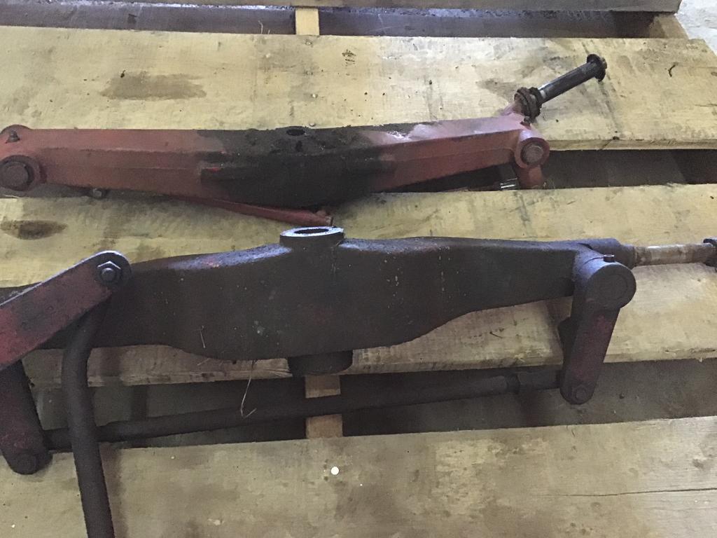

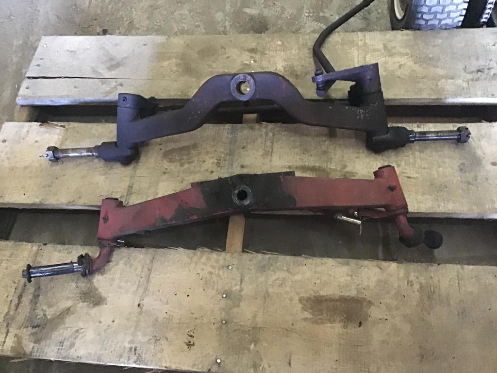

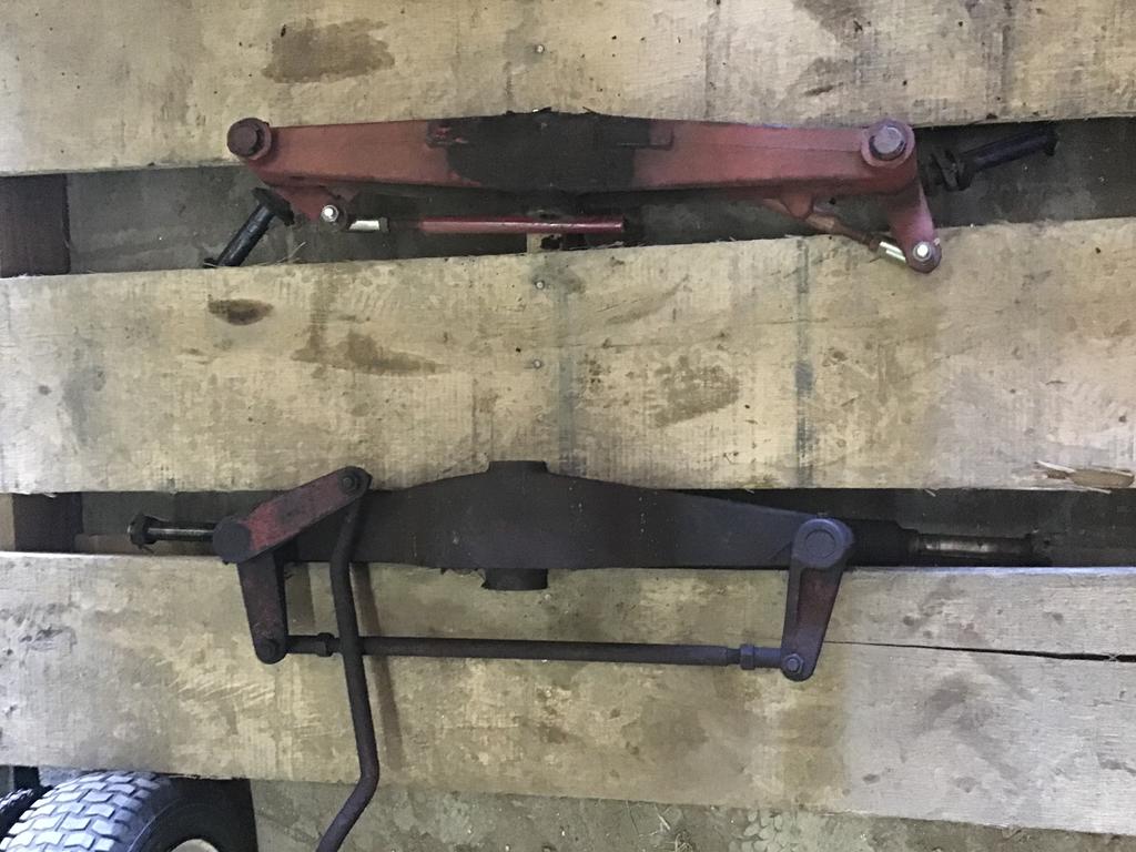

Pullstart 71,386 #557 Posted April 26, 2020 He EB. Check this out! Here’s a front axle that a guy like me and you is used to... next to one from a GT-14. WOW this thing is huge in every dimension! 3 1 1 Share this post Link to post Share on other sites

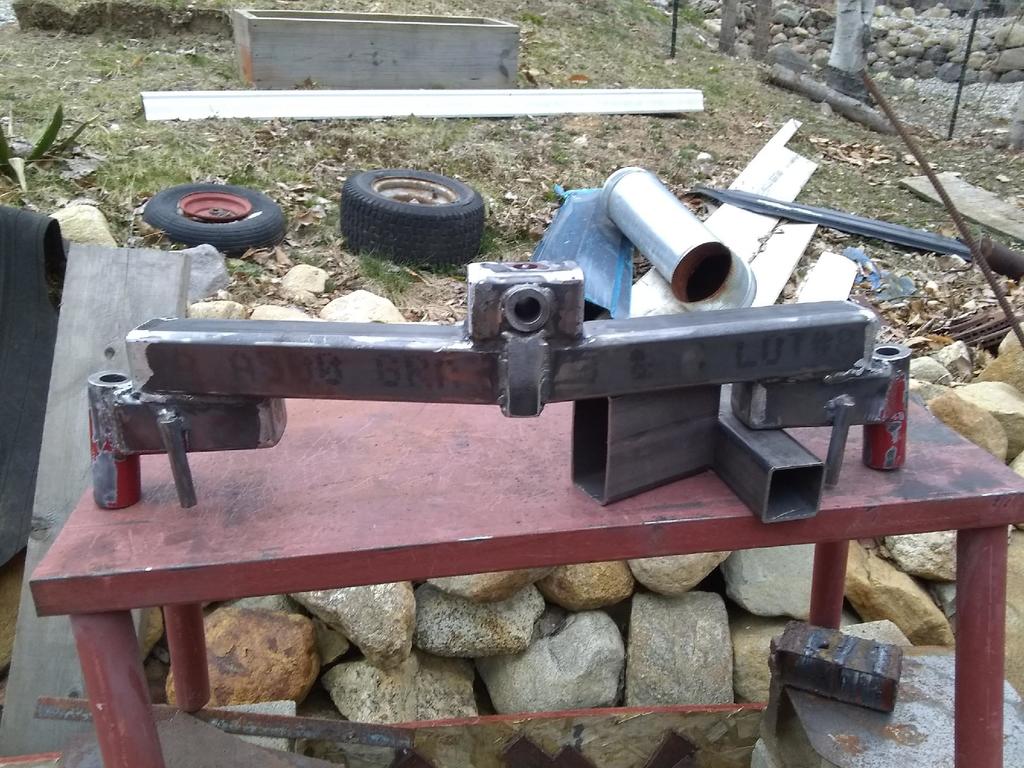

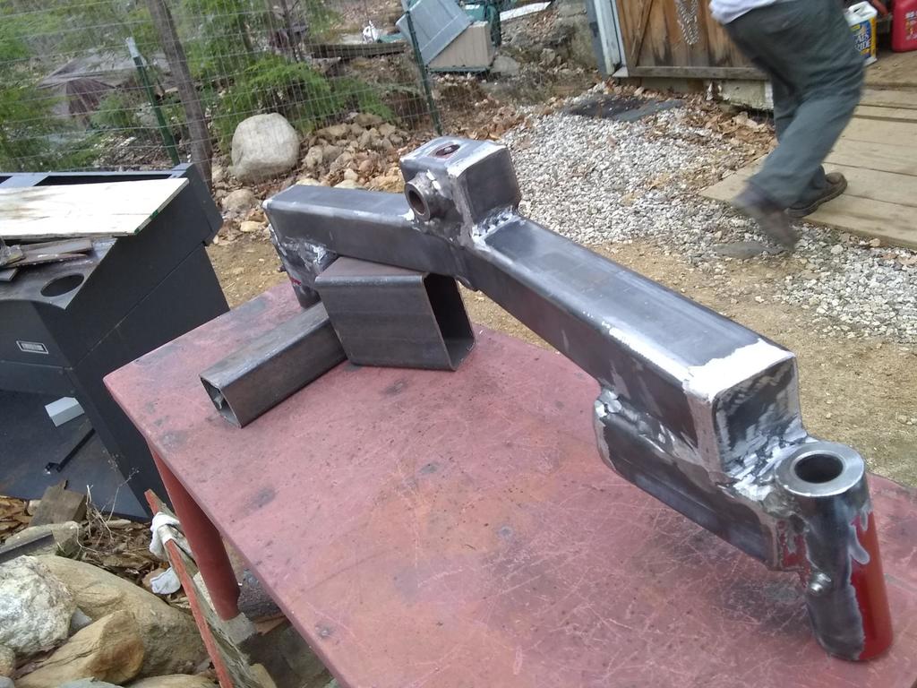

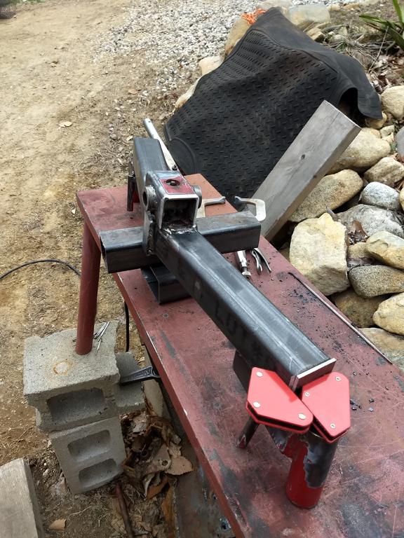

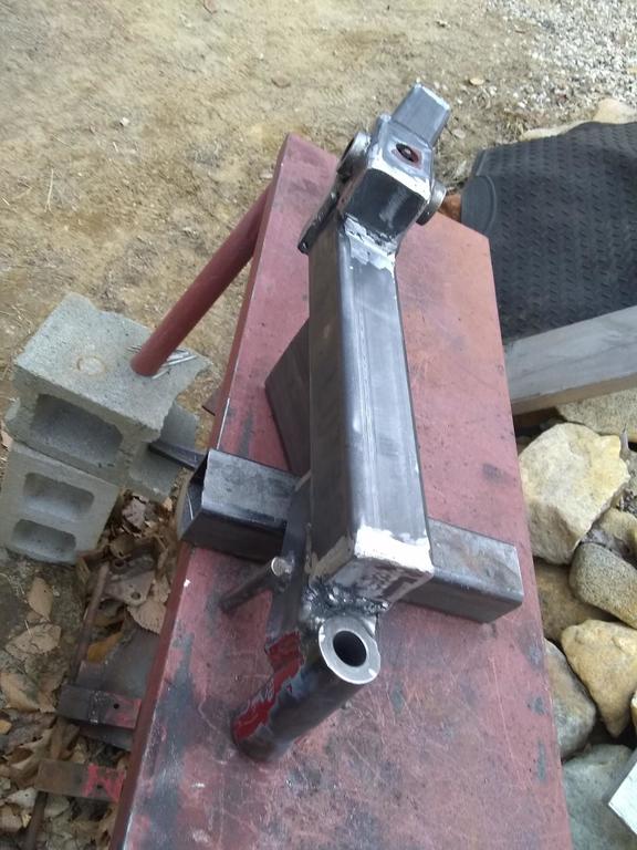

ebinmaine 80,975 #559 Posted April 26, 2020 Spent a few hours this afternoon experimenting with welding again. The front axle modification and build is complete. I added the second small brace cover piece to cap and reinforce the split in the middle where I put the forward sweep in the axle beam. Found a scrap piece of .100 sheet metal and cut six pieces to make end caps. Ground down the ends of the two inch square tubes to make room for the welds. I messed around with some 3/32 6011 rod and was able to make that work which I was pretty happy about. I used it to weld all of the end caps on. Then, ground down all the welds so they are basically flat end caps. I'm very very happy with the way this thing turned out. Never tried anything like this before. Absolutely fantastic learning experience. 3 9 1 Share this post Link to post Share on other sites
8ntruck 9,354 #560 Posted April 27, 2020 Looks good. We're you considering weighted front wheels on Colossis? If so, you could cast some lead inside the axle instead of adding front wheel weights. Share this post Link to post Share on other sites
ebinmaine 80,975 #561 Posted April 27, 2020 7 hours ago, 8ntruck said: Looks good. We're you considering weighted front wheels on Colossis? If so, you could cast some lead inside the axle instead of adding front wheel weights. How does one go about that? I'm not concerned with the front so much but the rear hitch/frame braces would be a candidate for it. Share this post Link to post Share on other sites
Stormin 9,988 #562 Posted April 27, 2020 9 hours ago, ebinmaine said: How does one go about that? I'm not concerned with the front so much but the rear hitch/frame braces would be a candidate for it. My way be to leave one end cap off, then pour molten lead into the box section. Finally weld the other end cap on. 4 Share this post Link to post Share on other sites
ebinmaine 80,975 #563 Posted April 27, 2020 5 minutes ago, Stormin said: My way be to leave one end cap off, then pour molten lead into the box section. Finally weld the other end cap on. What does it take to be able to melt lead? Share this post Link to post Share on other sites
wallfish 20,689 #564 Posted April 27, 2020 Or, fill it with lead shot https://www.rotometals.com/lead-shot/ Or, if you have a bunch of drawers or boxes full of hardware fill it with that. Anything is better than nothing. You can add steel powder too. Use whatya got 3 1 Share this post Link to post Share on other sites
Stormin 9,988 #565 Posted April 27, 2020 (edited) 1 hour ago, ebinmaine said: What does it take to be able to melt lead? Not a lot. It's rather like solder. You can use an old pan, preferably with a pouring lip. Put you lead into it and place on a camping stove. If you have a flame torch or oc/acet cutting gear use that. I've a quantity of lead flashing from eldest son in laws roof. To well off to weight it in. So I did, but kept half for myself. Used some for the Black Horses wheel weights. Still plenty left. Want some? Or a John said. Fill with lead shot. Edited April 27, 2020 by Stormin 1 Share this post Link to post Share on other sites
ebinmaine 80,975 #566 Posted April 27, 2020 21 minutes ago, Stormin said: Want some Yeah jump on the plane and bring it over 5 Share this post Link to post Share on other sites
8ntruck 9,354 #567 Posted April 27, 2020 Lead melts at something like 625 degrees F. A propane torch would do it. I'm planning on filling the 2x2 square tube on the receiver hitch I'm going to make for my horse with lead. I'm planning on wielding a solid end cap on one end and an end cap with a 1" hole on the other end. Stand the tube on end and fill it through the hole. I'm not comfortable making a weld joint on a lead filled pipe with no vent. 2 1 Share this post Link to post Share on other sites
ebinmaine 80,975 #568 Posted April 27, 2020 2 minutes ago, 8ntruck said: end cap with a 1" hole so you just fill it until the lead starts flowing at the top and leave it? Clean it up later.... Share this post Link to post Share on other sites
8ntruck 9,354 #569 Posted April 27, 2020 16 minutes ago, ebinmaine said: so you just fill it until the lead starts flowing at the top and leave it? Clean it up later.... Haven't done it yet, but that's my plan. Another option would to thread the hole and close it with a bolt or set screw after pouring the lead. 1 1 Share this post Link to post Share on other sites
Stormin 9,988 #570 Posted April 27, 2020 (edited) 35 minutes ago, ebinmaine said: so you just fill it until the lead starts flowing at the top and leave it? Clean it up later.... I'm not sure if the lead, when cooled would stay put over time. Two options. (1) As 8ntruck says. And I should have mention a vent hole. (2) Drill a hole or two through the box section to take some bar. Weld the ends to the box section and clean up, then pour in the lead. That'll secure the lead. No second end cap needed. Edited April 27, 2020 by Stormin 1 Share this post Link to post Share on other sites
