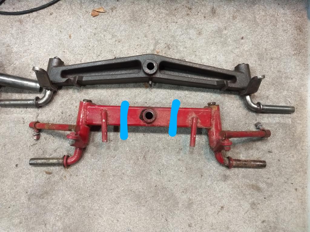

ebinmaine 80,975 #520 Posted April 10, 2020 Here's a picture comparing the stock horse axle and the custom axle I'm thinking about modifying for use. The custom axle makes a tractor sit about an inch higher than stock. I believe that was done to allow the frame to be level with the tiny wheels/tires that were on it. I'd cut at the blue lines. Take a piece of 2" square tubing and put the center section on TOP in the middle. The 2 outside pieces BELOW at the ends. This would accomplish 2 things. A. Obviously extend the length. B. Raise the tractor 2" + in the front to allow for more tire clearance and also ground clearance. 3 1 Share this post Link to post Share on other sites
8ntruck 9,354 #521 Posted April 10, 2020 Sounds like a pretty good plan. Going to include fish plates/gussets in that modification? 1 Share this post Link to post Share on other sites
Cvans 1,009 #522 Posted April 10, 2020 Go for it, Maybe you will start a new trend. 1 Share this post Link to post Share on other sites
Tractorhead 9,217 #523 Posted April 10, 2020 Worth a try. 1 Share this post Link to post Share on other sites
ebinmaine 80,975 #524 Posted April 10, 2020 4 hours ago, 8ntruck said: Sounds like a pretty good plan. Going to include fish plates/gussets in that modification? Hadn't thought of it. I like the idea. Triangular braces at the corners? Share this post Link to post Share on other sites
ebinmaine 80,975 #525 Posted April 10, 2020 7 hours ago, 8ntruck said: Sounds like a pretty good plan. Going to include fish plates/gussets in that modification? Or more like a plate like a railroad track holding the two rails together? Just welded, not bolted.... Share this post Link to post Share on other sites
