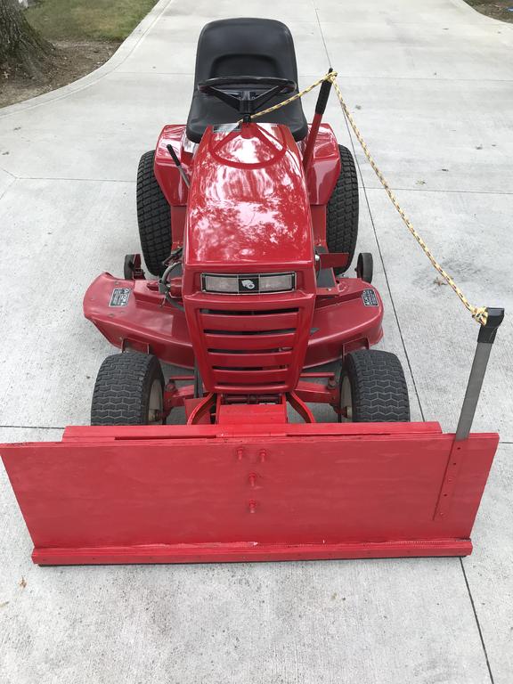

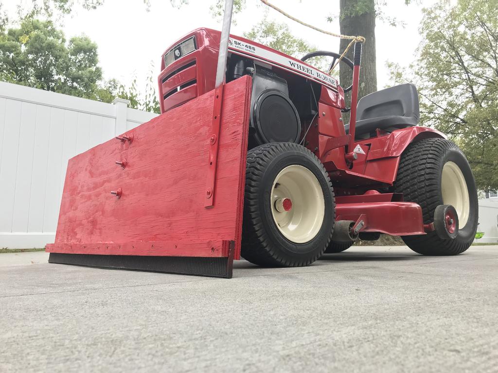

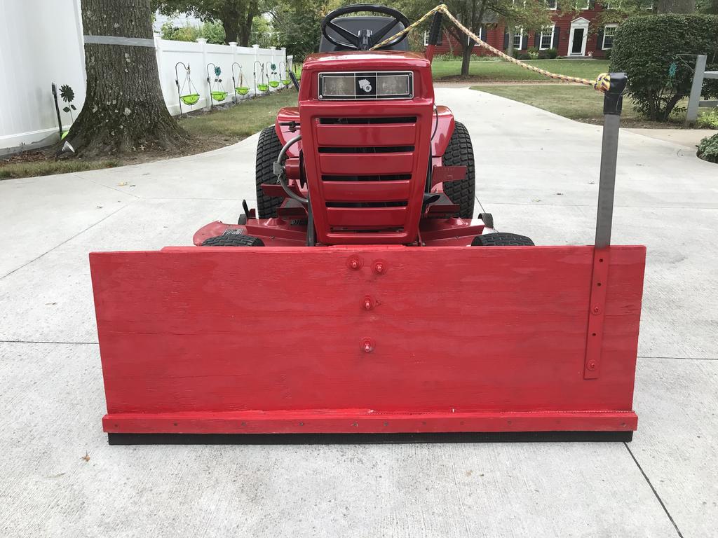

Al C. 1,474 #34 Posted September 8, 2019 Per everyone’s feedback, here is the final modification. 1 1/2 inch rubber edge. I’m ready for some snow! Share this post Link to post Share on other sites
