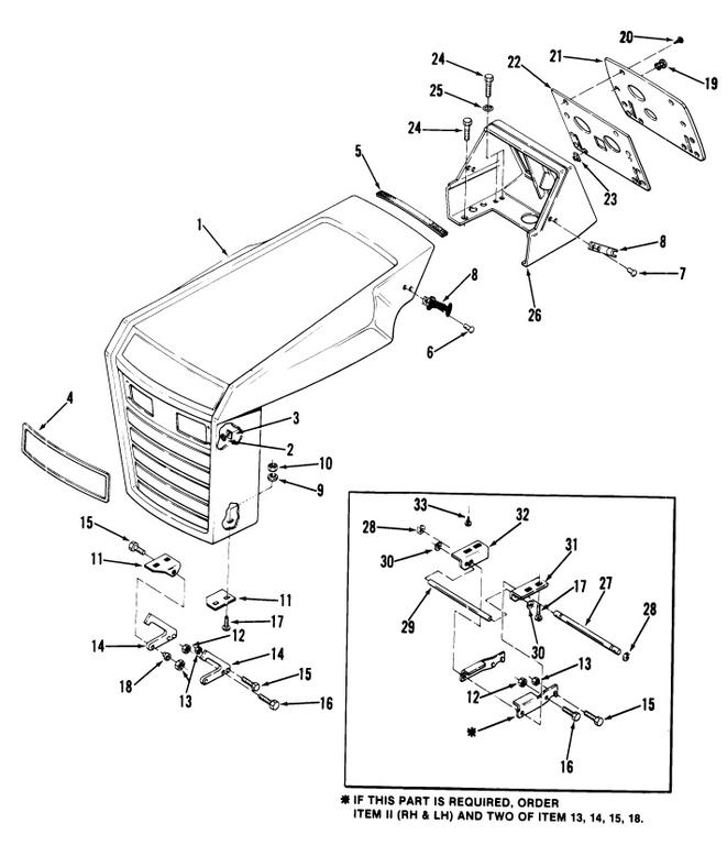

redone 45 #1 Posted August 24, 2019 This bothers me, I yet to figure this out. I do have two tractors same problem. Raise hood it goes all the way forward to the ground. Just painted the tractor and it scratch the hood. What hinge do I need to stop this from falling forwarded? Thanks for your advice Bill Share this post Link to post Share on other sites
gwest_ca-(File Mod) 12,483 #2 Posted August 24, 2019 Looks like there was a design change with the one in the box being the early style. This page from the 1980 ipl for model 01-17K801. 11 108590 BRKT-HOOD PIVOT LH 1 11 108589 BRKT-HOOD PIVOT RH 1 13 915111 Nut 4 14 108588 BRACKET-HOOD SUPT 2 15 908003 Bolt 4 18 108599 BUSHING-PIVOT 2 Garry 1 Share this post Link to post Share on other sites
The Tuul Crib 7,354 #3 Posted August 24, 2019 Add a chain on the inside of the hood as a stop to remedy this. 1 Share this post Link to post Share on other sites
pfrederi 21,145 #4 Posted August 24, 2019 #14 is what you need Share this post Link to post Share on other sites
