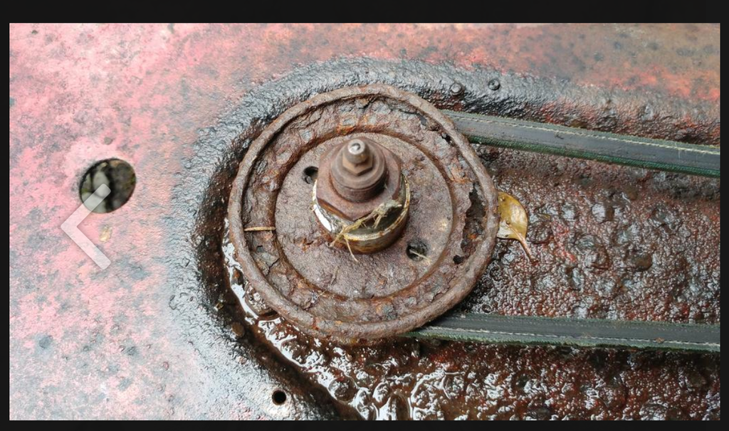

boondockboost 34 #1 Posted August 22, 2019 Hey everyone, I have a 42in side discharge deck on my raider 12, the one spindle pulley is hanging on for dear life, i wanted to order a new pulley and i came across a parts breakdown. It shows toro #6757 is that correct? Would anyone happen to have one for sale? Or know a site thats not 150$ for one Share this post Link to post Share on other sites

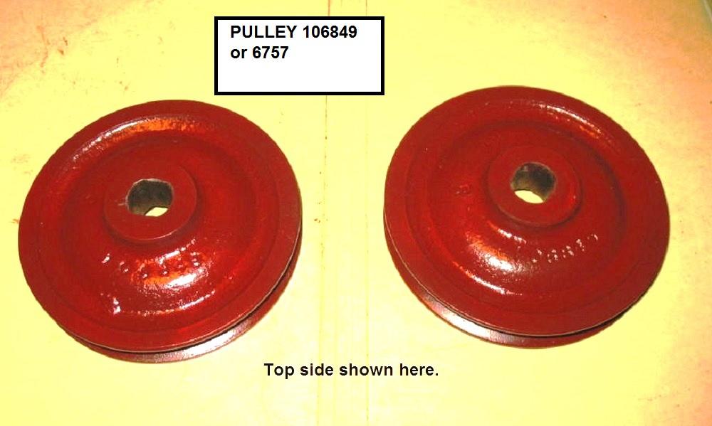

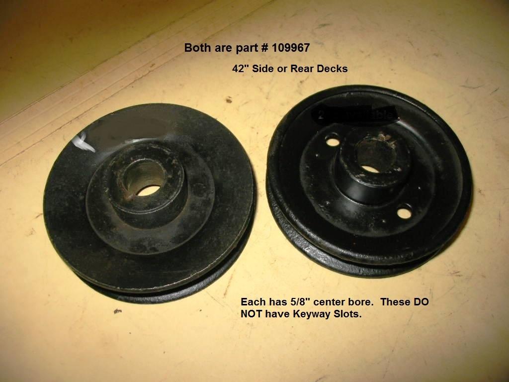

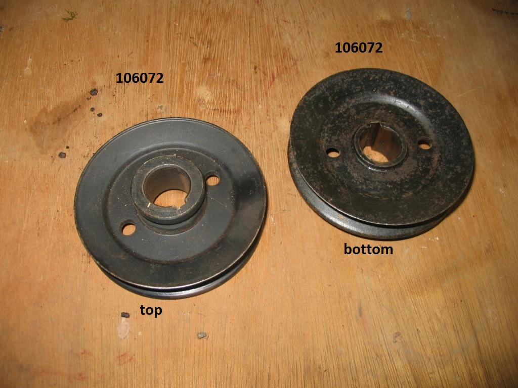

daveoman1966 3,884 #2 Posted August 22, 2019 That is NOT pulley 6757 in your pic. 6757 (or 106849) is a cast iron 'Double-D' pulley and, although it MAY have been original, that spindle in your pic is NOT. Your 42" deck wants either pulley # 106072 (with keyway) or 109967 (no keyway.) Take the spindle nut off to see oif the pulley is keyed, or not. (I don't think it is judging from the size of the spindle nuit.) Share this post Link to post Share on other sites
boondockboost 34 #3 Posted August 22, 2019 109967 no keyway looks like the one im looking for i appreciate the help! Share this post Link to post Share on other sites

Ed Kennell 46,998 #5 Posted August 22, 2019 5 hours ago, boondockboost said: Hey everyone, I have a 42in side discharge deck on my raider 12, the one spindle pulley is hanging on for dear life, i wanted to order a new pulley and i came across a parts breakdown. It shows toro #6757 is that correct? Would anyone happen to have one for sale? Or know a site thats not 150$ for one Are you still mowing with this deck? amazing 1 Share this post Link to post Share on other sites
boondockboost 34 #6 Posted August 23, 2019 Yeah, it looks alit worse in pictures than ut actually is. Theres 2 nickle size holes other than that its good Share this post Link to post Share on other sites
