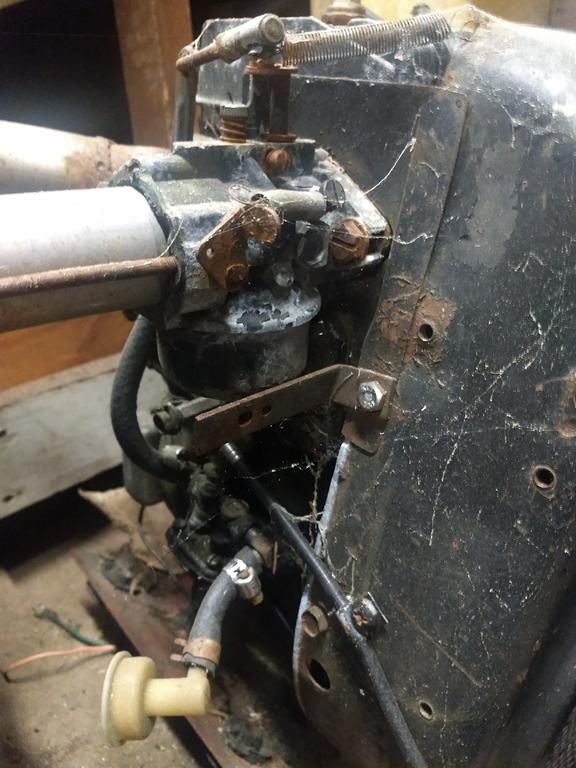

ebinmaine 81,148 #29 Posted August 31, 2019 Here's a picture of a 12 horse that was destined to be on a gocart. It has a Shaker plate bolted to the bottom of it so the vintage would have been something like 78 to 82. Maybe a little later. Black paint could tell you that it is a replacement engine. I say all that because I do realize it's not as old as yours but this is the hook up I have on two or three different C Series here. Note the lever that sticks out right even with the bottom of the bowl of the carburetor. The choke is the triangular lever just above it. Cable of course would have come up from the bottom. 1 Share this post Link to post Share on other sites
