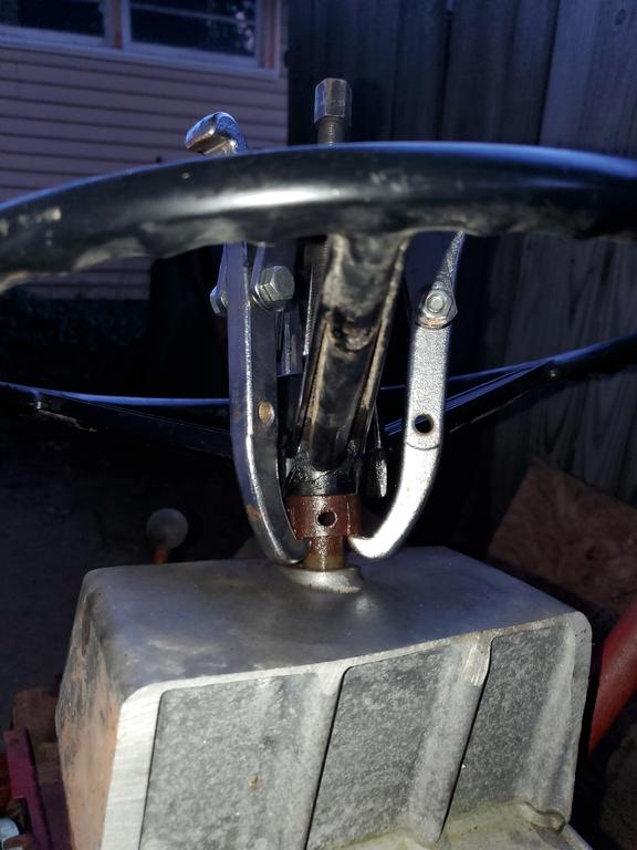

Charley 40 #1 Posted August 20, 2019 Is this a proper method for pulling my steering wheel off? The pin is out and kroil has been applied. I cant help but think its fighting against itself. Share this post Link to post Share on other sites

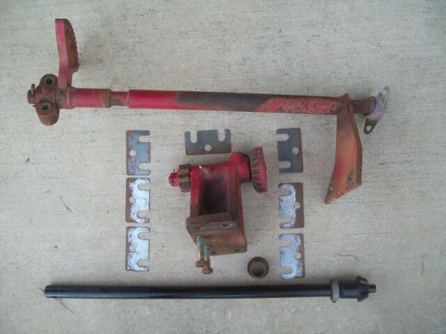

bc.gold 3,406 #7 Posted August 20, 2019 If your steering gear is similar make a thick spacer ( C ) to slip over the shaft to take up the slack near the pinion gear then use a slide hammer to remove the steering wheel. Even if there's no slack at the pinion use the spacer to keep the pinion stationary. Share this post Link to post Share on other sites
Charley 40 #8 Posted August 20, 2019 Slow and steady. Thank you gentlemen! 1 1 Share this post Link to post Share on other sites

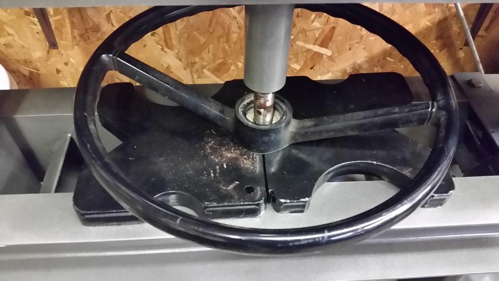

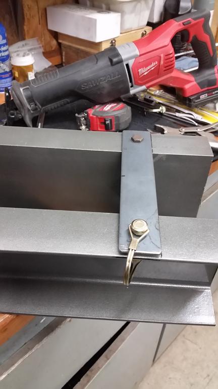

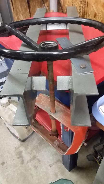

WHX?? 53,081 #11 Posted August 20, 2019 (edited) I modified my H press as to be able to slip the whole shebang in it so no more steering wheel removal issues for me. Now to figure out hubs! My bad... Charley! Edited August 20, 2019 by WHX24 welcome 2 1 Share this post Link to post Share on other sites

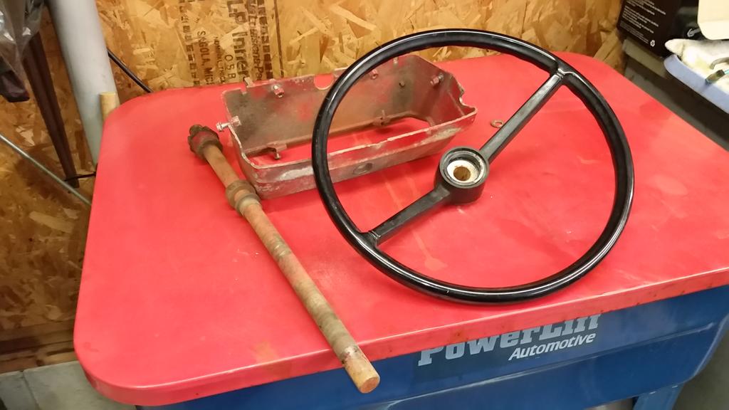

Charley 40 #13 Posted August 20, 2019 Somebody cut the gas tank off, I have a new gas tank and dash for it, I have all winter to get her cleaned up! 2 Share this post Link to post Share on other sites
