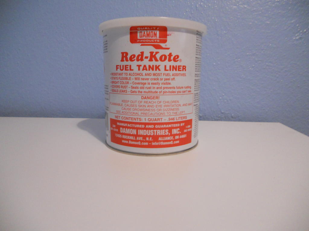

Wheelhorse Wes 279 #1 Posted August 18, 2019 My newest tractors I brought home last Sunday (2) 854’s well I put gas in one that has it’s engine and there is 2 spots leaking on the gas tank. I don’t like these 2 piece tanks to begin with and this doesn’t help so how do I fix it? There is a tank gasket on eBay but in his comments says to also use a sealer gasket goo.....do I have to buy this gasket or what gasket goo do I use to seal this tank? I plan on restoring this tractor for my father who lives in Alberta Canada so I don’t want any leakage problems down the road for him...thanks guys 1 Share this post Link to post Share on other sites

Racinbob 12,883 #4 Posted August 18, 2019 This stuff works wonders. There's other sealers out there that I'm sure are great but this fixed my 854. 1 Share this post Link to post Share on other sites
moe1965 774 #5 Posted August 19, 2019 Yes red kote all the way I did it to my 854 ad well and a aluminum tank on a gravely two years ago both still going strong Share this post Link to post Share on other sites
