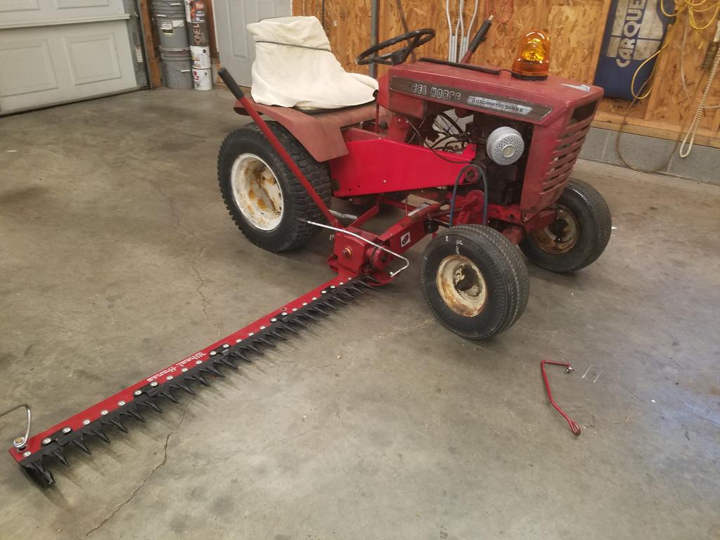

ebinmaine 77,123 #13 Posted August 21, 2019 1 hour ago, oldredrider said: I've been building a Franken Tractor Do you have a thread on this? 1 Share this post Link to post Share on other sites
oldredrider 2,553 #14 Posted August 21, 2019 Sorry, no thread. I like running under the radar! Once it's finished I might post a pic or 3. Here's a teaser... 3 2 1 Share this post Link to post Share on other sites
