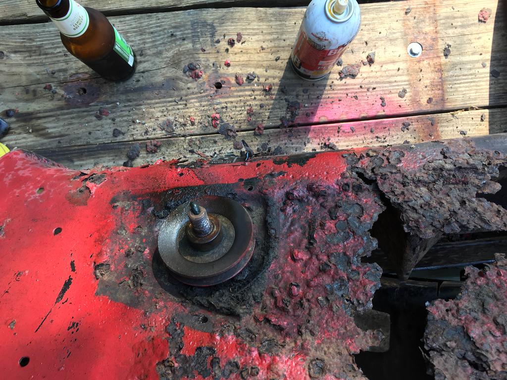

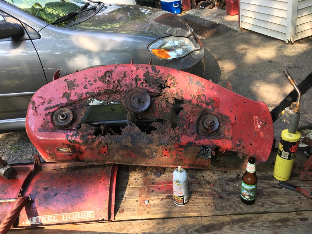

Burnerman 759 #1 Posted August 15, 2019 I’m trying to salvage the spindles from what’s left of this deck. I got the torch, PB and a beer contemplating this task. The only tool I don’t have is a fan hub puller but I’m not sure the set screws would grip the hub strong enough. Is there any tricks to this? Thanks in advance. Share this post Link to post Share on other sites

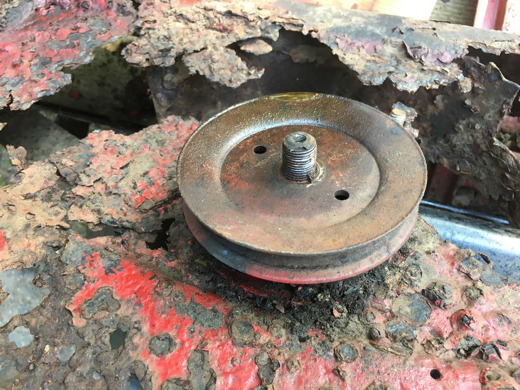

daveoman1966 3,880 #8 Posted August 15, 2019 For the center pulley, drill open the two holes to 3/8" dia. Then fashion a 'J' hook from 3/8 (or 5/16) HARD rod to work in a 2-slot hub puller... To avoid damage to grease zerk threads, us a flat puller socket instead of a pointed one....or be prepared to renew the threads. Also...thread the spindle nut back on to be FLUSH with top of spindle shaft. Put hooks into holes and draw spindle pulley off. You MAY be able to do the same thing with the side pulleys...drill 2 holes 3/8" dia opposite of each other... 1 1 Share this post Link to post Share on other sites
adsm08 3,841 #9 Posted August 15, 2019 I see the pullies, where is the deck? 2 Share this post Link to post Share on other sites
Burnerman 759 #10 Posted August 15, 2019 Daveoman66, that’s the kind of ideas I was looking for! I’ll heat and soak a few days and I’ll get out the drill. I saw the holes in the center pulley and wondered why they’re there.👍👍 Share this post Link to post Share on other sites

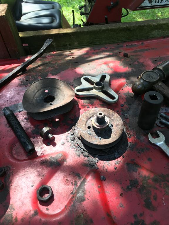

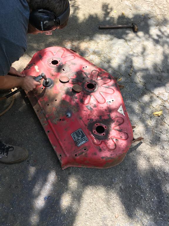

BOB ELLISON 2,981 #12 Posted August 16, 2019 This is how I removed my pullys. 3 Share this post Link to post Share on other sites
peter lena 9,552 #13 Posted August 16, 2019 on your 3 rd picture down, you can just see the head of the spindle mounting bolt, with 2 two angular pinch bars , putting the pinch bar angles on top of either side mounting bolts will let you push down , the pinch bar will push against the lower center flange of the spindle , its strongest point , and give you the mechanical advantage. having just did this on two 42 " r/d decks , it makes things easy . lubricate pulley to center shaft just prior to double pinch bar removal, all 6 of my spindle pulleys came off easily . you have to EQUALLY PUSH UP ON THESE PULLEYS , at the center of the pulley, not the outer edge. i am giving you the advise , because it worked for me, good luck with it pete Share this post Link to post Share on other sites

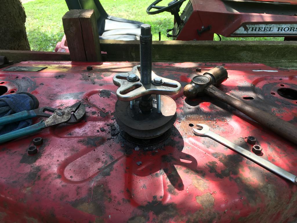

daveoman1966 3,880 #21 Posted August 18, 2019 7 hours ago, Burnerman said: I thought removing a stuck hub was bad. I’m really starting to hate the deck pulley design. Lol When you had this PULLER with a lot of tension / strain on it, did you give the HEX end of the puller a good healthy WHACK with a BFH to break loose the pulley... just a thot. Share this post Link to post Share on other sites
Burnerman 759 #22 Posted August 18, 2019 20 minutes ago, daveoman1966 said: When you had this PULLER with a lot of tension / strain on it, did you give the HEX end of the puller a good healthy WHACK with a BFH to break loose the pulley... just a thot. Oh yeah! Lol. That’s when it started to bend the pulley. I gave it everything after that and separated the top pulley. My older deck has keyed pulleys and they came off a lot easier but they’re rusted out. I need to use the keyed pulleys in the solid deck shell. 35 minutes ago, daveoman1966 said: EBAY... $45 + for the pulley... search" toro 106072" That’s $90 plus I need the center pulley at $88 👀. This cheap deck is getting expensive. 😁 I need a cheaper alternative. Share this post Link to post Share on other sites
