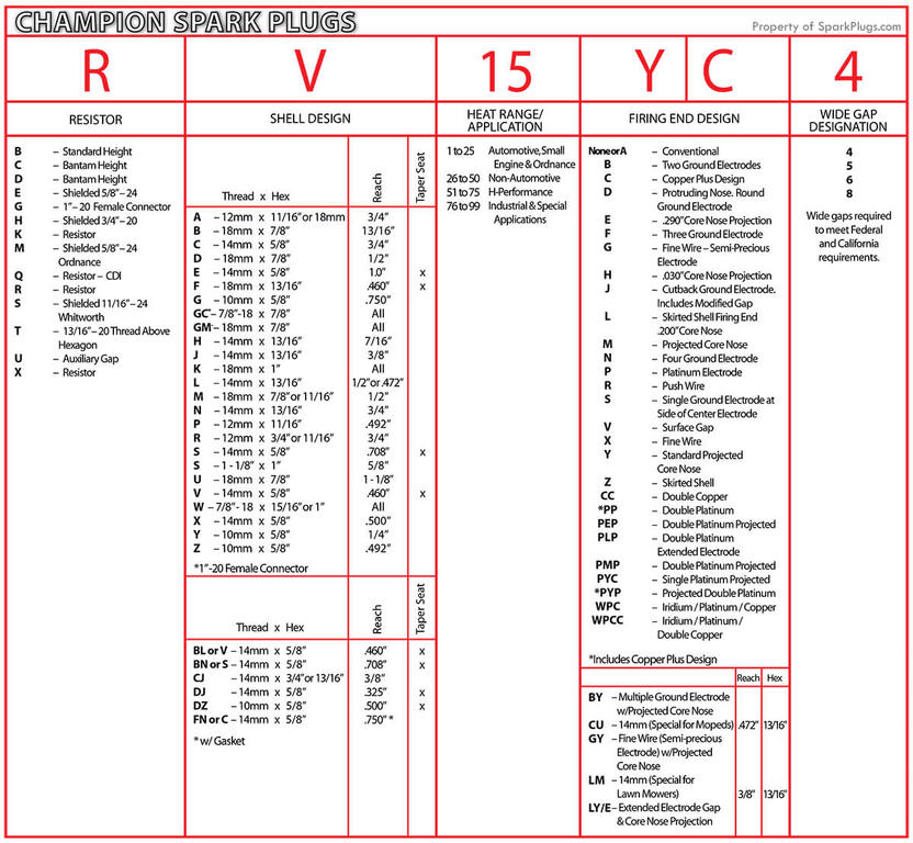

gwest_ca-(File Mod) 11,981 #15 Posted October 25, 2019 On 10/22/2019 at 8:51 AM, Mudrig150 said: it's supposed to have Champion RV17YC, it has RV12YC, which is WAY too long. Probably also what contributed to the bad running... The two plugs should be identical except for the heat range - 12 being a colder plug than 17. https://www.fme-cat.com/overlays/part-detail.aspx?brandId=CP&pNum=25&partType=Spark Plug Garry Share this post Link to post Share on other sites
Mudrig150 376 #16 Posted October 25, 2019 RV12YC has about 1" of threads, and they protrude into the engine, coming close to hitting the valves. RV15YC is the correct length, but the wrong heat range, I think. RV17YC is the correct plug. Old magnum has RV15YC, New one has RV12YC. Looking at it, the bent threads are probably what stripped the head out. Share this post Link to post Share on other sites
gwest_ca-(File Mod) 11,981 #17 Posted October 25, 2019 There has to be something wrong with what you have and their numbers. Open these and click on the specification tabs. They all have tapered seat so no gasket. RV12YC https://www.fme-cat.com/overlays/part-detail.aspx?pNum=406&partType=Spark Plug&brandId=CP RV15YC https://www.fme-cat.com/overlays/part-detail.aspx?pNum=18&partType=Spark Plug&brandId=CP RV17YC https://www.fme-cat.com/overlays/part-detail.aspx?pNum=25&partType=Spark Plug&brandId=CP Garry Share this post Link to post Share on other sites
gwest_ca-(File Mod) 11,981 #18 Posted October 25, 2019 Took a lot of looking but found the Champion plug spec chart Added it to our files as a pdf also so it can be downloaded. Garry Share this post Link to post Share on other sites
Mudrig150 376 #19 Posted October 25, 2019 Oh, they are rC12yc. That's why they're so long. Then, why did the picture show an RC plug when I searched for an RV plug? Share this post Link to post Share on other sites
