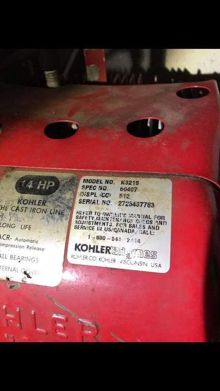

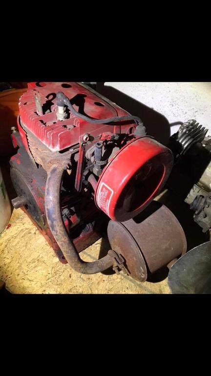

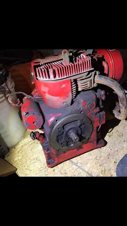

Burnerman 759 #1 Posted August 14, 2019 My son got a line on a used K321s for a fair price but will need a rebuild. Will a K321s big block fit in place of a K181 on a C85? It appears the engine cradle gets removed and the engine will get bolted directly to the frame. Is this correct? Also the dipstick on the 321 is under the starter. Is this engine worth installing or should we keep looking? Share this post Link to post Share on other sites

oldredrider 2,553 #3 Posted August 14, 2019 The output shaft needs to be the correct length and diameter to run a Horse PTO 2 Share this post Link to post Share on other sites
Pullstart 68,534 #4 Posted August 14, 2019 1 hour ago, oldredrider said: The output shaft needs to be the correct length and diameter to run a Horse PTO Yeah, that is way too short to run the Wheel Horse pto... and I’m not sure, but I believe only some variations of the K series engines are side load prepped? Or are they all roller bearing cranks? Share this post Link to post Share on other sites
peter lena 9,571 #5 Posted August 14, 2019 that crank length is the issue, i would look for something that is a bolt in , otherwise you are going to repeat all your work. you could sell off this engine and concentrate on a newer type bolt in. the money you would spend to rebuild it could easily upgrade to a newer fresher engine. if you found a 10/ 12 hp with 4 to 5 hundred hrs on it , you could easily recover it , ( freshen it up ) and you would be good, it would also bolt in and pto work. pete 1 Share this post Link to post Share on other sites

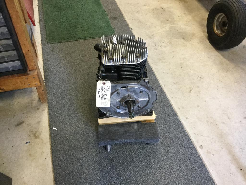

richmondred01 2,319 #6 Posted August 14, 2019 (edited) That’s a gravely engine. The crank is too short however that can be swapped. Gravely machined the pto side of the block to form a circular ledge. That to can be shimmed to hold the wheel horse pto bracket. Also, the pan for the gravely don’t have the drilled and tapped holes for mounting. However, with all that said it can be done but is it worth it? I have a wheel horse spec k321 long block that has been completely rebuilt ( bored, crank ground, valves seats ground) that includes the pan and head. You can bolt up the gravely carb, starter, fuel pump, flywheel, coil, points, stater and sheet metal and be done and ready to install in 30 minutes. Or I have the complete ready to bolt on rebuilt k341. Pm me if interested Edited August 14, 2019 by richmondred01 1 Share this post Link to post Share on other sites
