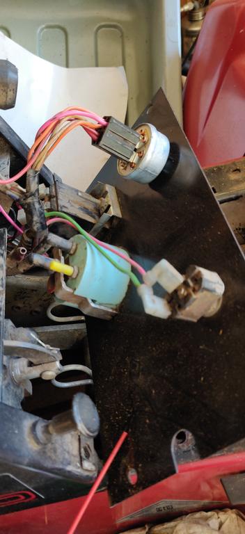

CountryRock 199 #27 Posted September 2, 2019 Finished getting the shroud back on and changed the engine oil yesterday. Also snugged up the friction washer on the motion control. I noticed the volt meter wasn't working last night, didn't have time to mess with it til today. Wires appear to be hooked up correctly. I started checking the rest of the electrical systems. Found that the battery seemed to be charging with erratic voltage at any throttle setting and it was way more than it should be getting. Fairly certain the voltage regulator is toast. Alternator appears to be putting out what it needs to. Ordered a used regulator and a new ignition switch from A-Z. I'll continue checking electrical stuff when I have more time. This tractor was blowing the 25amp fuse at one time, I want to make sure that won't happen again. Share this post Link to post Share on other sites
lynnmor 9,072 #28 Posted September 2, 2019 Since you were working with the blower housing, perhaps the voltage regulator is not grounded properly. It works by directing current to ground so it needs good electrical contact where it is mounted. The engine manual has good troubleshooting instructions if you continue to have problems. I have used the cheap regulators found online with good success. The old analog style voltmeters are better than digital for working on these systems. With the regulator trying to regulate many times per second, an analog pointer will average out those pulses, but a digital will go crazy trying to keep up. Share this post Link to post Share on other sites

CountryRock 199 #34 Posted October 5, 2019 Got around to checking out electrical connections today. Starting with the ignition switch connector, I pulled each wire out of the connector, 1 by 1 and sprayed the terminals with contact cleaner and put em back in. I installed a new ignition switch as well and hooked that up. Did the terminals on the hour meter, volt meter and light switch too. Then I did the 9 pin connector up by the battery, the fuse block and finally the one down next to the engine. I installed another voltage regulator and now the engine charges the battery as it should. However I still couldn't get the volt meter to work, so I swapped it with another I had sitting in the garage, but still nothing. The 9 pin connector by the engine raised some concerns as it looked like a couple wires were cut on one side, and some were missing. Also, the lights stopped working for some reason. I'll have to go study some wiring diagrams later and figure out what is what. 1 Share this post Link to post Share on other sites
Andy N. 2,881 #35 Posted October 11, 2019 On 10/5/2019 at 6:13 PM, CountryRock said: Got around to checking out electrical connections today. Starting with the ignition switch connector, I pulled each wire out of the connector, 1 by 1 and sprayed the terminals with contact cleaner and put em back in. I installed a new ignition switch as well and hooked that up. Did the terminals on the hour meter, volt meter and light switch too. Then I did the 9 pin connector up by the battery, the fuse block and finally the one down next to the engine. I installed another voltage regulator and now the engine charges the battery as it should. However I still couldn't get the volt meter to work, so I swapped it with another I had sitting in the garage, but still nothing. The 9 pin connector by the engine raised some concerns as it looked like a couple wires were cut on one side, and some were missing. Also, the lights stopped working for some reason. I'll have to go study some wiring diagrams later and figure out what is what. How do you remove the wires from the connector? Is there a special extraction / insert tool for this? Share this post Link to post Share on other sites
JoeM 10,317 #36 Posted October 11, 2019 41 minutes ago, Andy N. said: How do you remove the wires from the connector? Is there a special extraction / insert tool for this? I believe you need a Molex removal tool, but there is a guy on the tube that does it with a couple of staples. I have not tried the staple thing but is worth looking at. 1 Share this post Link to post Share on other sites
peter lena 10,105 #37 Posted October 11, 2019 from the looks of your connectors, one of the first things i would do , just to verify power flow , is to lightly sandpaper the male side of the plug , to enhance the connection , and use a small amount of DIELECTRIC GREASE on the pug in ends, that by itself might give you a sign of life. you can also find those connectors on line ,giving you the opportunity to cut out and remove the problem . good grounding is vital to that dash area, and making up a couple of grounding wires , from chassis is easy. jmoo, pete 1 Share this post Link to post Share on other sites
CountryRock 199 #38 Posted October 11, 2019 2 hours ago, Andy N. said: How do you remove the wires from the connector? Is there a special extraction / insert tool for this? I bought a cheap set of terminal tools from Amazon a while back. Less than $10 and very handy for a variety of connector types. 1 Share this post Link to post Share on other sites
