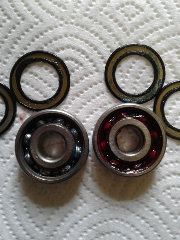

Stike 204 #10 Posted August 10, 2019 The first thing I do when I get sealed bearings is use an oring pick to remove one seal and clean all the factory grease out and replace with good quality marine grade grease, I've found that the factory grease is not high quality and they don't put much in to start with, then if needed replace the seal or leave out if they can be greased from a fitting. The left bearing is factory right is new grease. 1 Share this post Link to post Share on other sites
