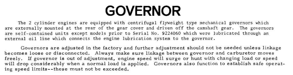

wallfish 18,791 #2 Posted August 10, 2019 First thing I would look at is the governor. Be sure the governor is set properly and operating. Check the linkage to the carb to be sure nothing is binding and everything moves with ease. This service manual should help. 1 Share this post Link to post Share on other sites
