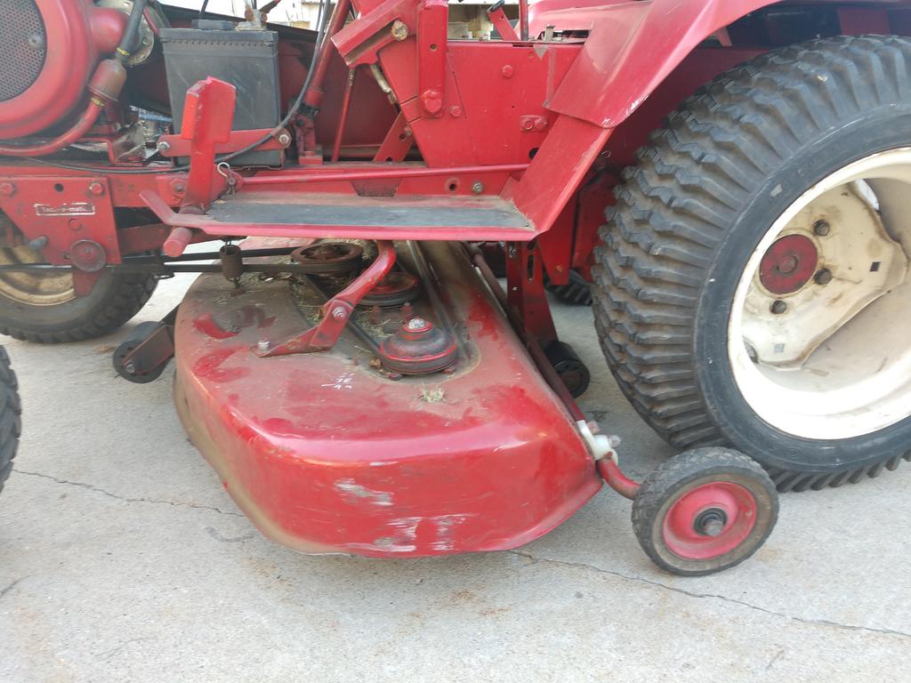

seven 202 #1 Posted August 8, 2019 I got this b80 with this mower deck on it couple of years ago but I'm not sure if and even belongs on this mower it's been welded and whatnot can anybody tell me if it would even work? Sorry model number is painted over Share this post Link to post Share on other sites
Wildhorse 303 #2 Posted August 9, 2019 That deck is for side mounted mule drive attach a matic from 70's models. Looks like you have front mount mule drive. Might be able to make it work. Maybe somebody else will have more info. Share this post Link to post Share on other sites
seven 202 #3 Posted August 9, 2019 Could someone send me a picture of a mower deck on a B80 Share this post Link to post Share on other sites
gwest_ca-(File Mod) 12,511 #4 Posted August 9, 2019 Believe the 5-0721 deck was the intended model deck for your tractor. This may help Garry Share this post Link to post Share on other sites
