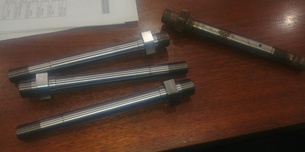

mrtbolt64 3 #9 Posted August 17, 2019 Thanks for the help. One pulley was a nightmare and required drilling it for bolts to accept a puller and also slotting it. The other two pulleys only required use of a pipe wrench and a impact gun and it was enough to get the pulley to free up. Total cost was 14 bucks and that was for a new pulley at Tractor Supply. New bearings were free since I work at a Bearing Warehouse, I machined new spindles, never seized everything, and what a difference it made in mowing. I feel like its a new mower as quiet as this deck runs. As cheap as the bearings are anyway I think every couple of years I will throw a new set in. 1 Share this post Link to post Share on other sites
daveoman1966 3,882 #10 Posted August 17, 2019 Looks GREAT..... When making the 3 spindle shafts, were you able to get the top end drilled and tapped for the grease fitting?? Share this post Link to post Share on other sites
mrtbolt64 3 #11 Posted August 17, 2019 1 minute ago, daveoman1966 said: Looks GREAT..... When making the 3 spindle shafts, were you able to get the top end drilled and tapped for the grease fitting?? Yes, we had new grease zerks here as well. Drilled 1/8 dia x 2-3/8 deep then .213 dia x .6 deep followed by a 1/4-28 tap. Then cross drilled. To make 4 shafts on the CNC lathe and Mill it took about 3 hours of my time. We had left over A2 tool steel bar stock laying around and that is what I made them from Share this post Link to post Share on other sites
lynnmor 8,644 #12 Posted August 17, 2019 I would be tempted to heat treat that A2 steel, tempering it at 850 degrees. Share this post Link to post Share on other sites
