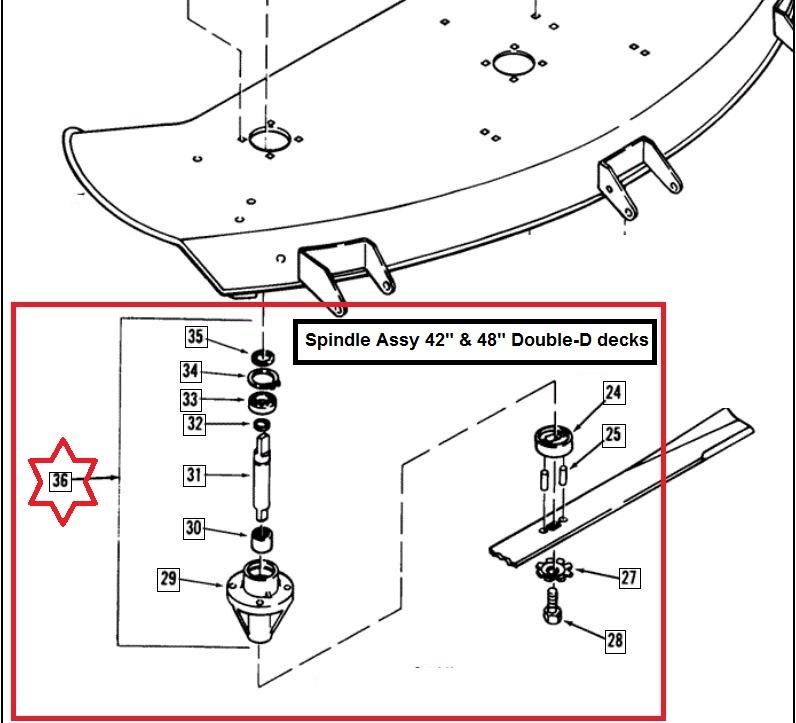

Bob Nakon 55 #1 Posted August 5, 2019 Hi all, I'm rebuilding my old mower deck. It has the double D spindles. Does anyone know where I could look at an assembly or schematic drawing of these spindles? Thanks, Bob Share this post Link to post Share on other sites
daveoman1966 3,882 #2 Posted August 5, 2019 (edited) Do these help... The schematic is the 42 and 48 spindles.. Edited August 5, 2019 by daveoman1966 2 2 1 Share this post Link to post Share on other sites

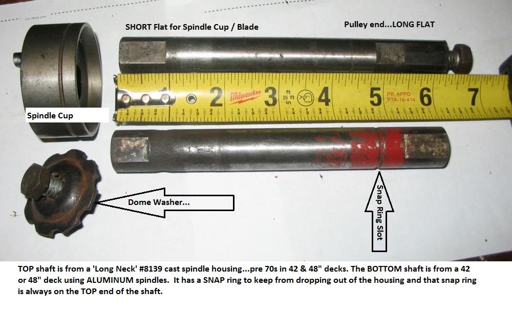

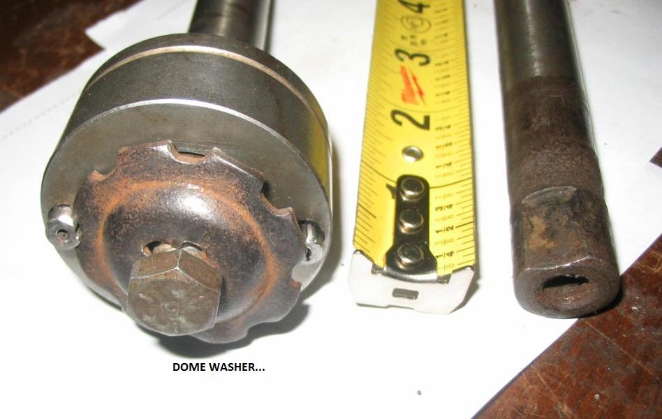

Bob Nakon 55 #3 Posted August 7, 2019 Thanks Dave! Man, your parts all look good. I’m using the shafts I got from you, but my dome washers are all split. Looks to me that the shaft is upside down in the drawing. The longer flats need to go down towards the blade I think. Somehow I got hold of a almost new spindle housing that is about 1/2” longer than the others. Too bad, it is almost new!! Bob Share this post Link to post Share on other sites
daveoman1966 3,882 #4 Posted August 7, 2019 I'm not sure which DD shafts I send....length wise, that is. The LONG flat on the DD spindle shaft is for the PULLEY. The Spindle Cup and Blade with DOME WASHER fit to the SHORT end of the spindle shaft. I don't have any decent dome washers but surely they can be had somewhere....I'll check around. Share this post Link to post Share on other sites
