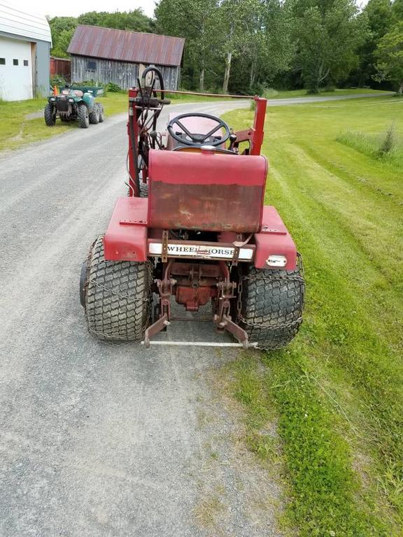

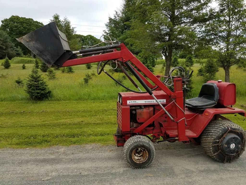

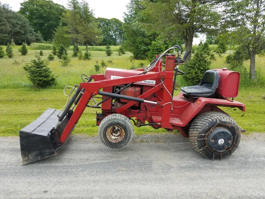

DavidP 10 #2 Posted August 4, 2019 Here some pics.. 3 Share this post Link to post Share on other sites

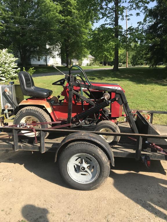

pfrederi 21,225 #9 Posted August 4, 2019 I used one of these to haul my D200 with FEL home Share this post Link to post Share on other sites

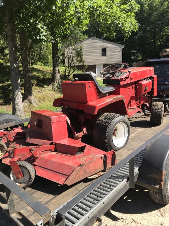

Firebug 267 #10 Posted August 14, 2019 I recently sold my d200. While it didn’t have a front end loader, I had a filler on it, and my 3 point finish mower on the trailer. It hung over the back of my 12’ trailer almost 12 inches. I have a Ford 18 hp diesel fel that isn’t much bigger that the d. It takes up almost the whole trailer. I would venture to guess you would probably need a 10’ trailer. The d with the finish mower is on a 12’ trailer, the c-85 with fel is on a 10’ trailer Share this post Link to post Share on other sites
