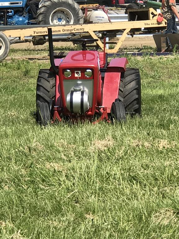

TonyToro 1,135 #1 Posted August 3, 2019 We had another pull yesterday. My son and Grandpa did awesome. Grandpa pulled 2 second places out of 14 pullers and Anthony did a 5th and 6th place out of 12. We just added 13” front tires to the Raider 14. It brought the front end down some but I’m looking for more rake. I noticed a guy had an interesting front end. I asked him what it was and he said he thought it was off a Suburban. It dropped his front end easy 2” more than ours. Has anyone used this model front axle? If so please let me know what you have used. Share this post Link to post Share on other sites

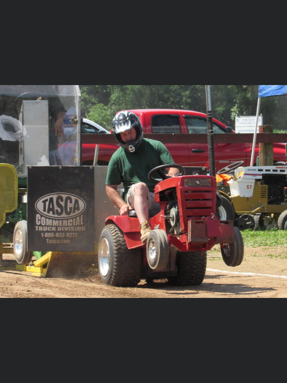

TonyToro 1,135 #2 Posted August 3, 2019 i just found this picture of Steve’s tractor. An axle like this is what I’m looking for, or anything similar to bring down the front end. Share this post Link to post Share on other sites

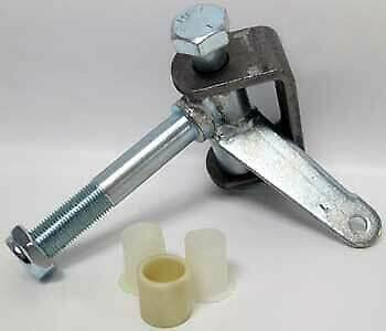

RandyLittrell 3,943 #4 Posted July 26, 2020 (edited) I have built a couple of axles for my cubs I pulled. If you have a welder, you can build without doing any machining. You could start with these. Just moving the axle up this far will drop the front end. https://www.ebay.com/i/184331980483?chn=ps&norover=1&mkevt=1&mkrid=711-117182-37290-0&mkcid=2&itemid=184331980483&targetid=915850928613&device=c&mktype=pla&googleloc=9023400&poi=&campaignid=10456336033&mkgroupid=106723176427&rlsatarget=aud-622524041478:pla-915850928613&abcId=2146001&merchantid=101490225&gclid=CjwKCAjw0_T4BRBlEiwAwoEiAU2Xyd_7YjCBuN6dmn2aAxRw3COtPnsLJCeis7GpH0Sp5EWW3SeUzRoCYv0QAvD_BwE Randy Edited July 26, 2020 by RandyLittrell 1 Share this post Link to post Share on other sites
953 nut 63,716 #5 Posted July 26, 2020 That is an axle from a Suburban on the front of Steve's puller. 1 Share this post Link to post Share on other sites

TonyToro 1,135 #7 Posted July 27, 2020 6 hours ago, RandyLittrell said: I have built a couple of axles for my cubs I pulled. If you have a welder, you can build without doing any machining. You could start with these. Just moving the axle up this far will drop the front end. https://www.ebay.com/i/184331980483?chn=ps&norover=1&mkevt=1&mkrid=711-117182-37290-0&mkcid=2&itemid=184331980483&targetid=915850928613&device=c&mktype=pla&googleloc=9023400&poi=&campaignid=10456336033&mkgroupid=106723176427&rlsatarget=aud-622524041478:pla-915850928613&abcId=2146001&merchantid=101490225&gclid=CjwKCAjw0_T4BRBlEiwAwoEiAU2Xyd_7YjCBuN6dmn2aAxRw3COtPnsLJCeis7GpH0Sp5EWW3SeUzRoCYv0QAvD_BwE Randy Yes... I was thinking about those go cart styles too. I used them on a racing mower. I was thinking about the complete axle so I could just swap it into the frame and reconnect steering, quick and easy....or I’m thinking it would be quick and easy?? 1 Share this post Link to post Share on other sites
TonyToro 1,135 #8 Posted July 27, 2020 1 hour ago, 953 nut said: That is an axle from a Suburban on the front of Steve's puller. Yes..yes...that one. Share this post Link to post Share on other sites
