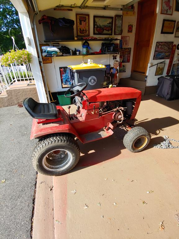

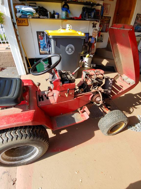

sergt3 8 #10 Posted August 7, 2019 here is the beast c111 8 speed, hole in the side size of a grapefruit, hopefully I have one coming, then the fun begins 4 Share this post Link to post Share on other sites
Pullstart 68,883 #12 Posted August 8, 2019 ! It looks clean enough to get going again... once you put the grapefruit back in the hole! 1 Share this post Link to post Share on other sites
sergt3 8 #13 Posted August 8, 2019 that is going to be the challenge..never did an engine change over..if I get hung up I know I can get help from redsquare 1 Share this post Link to post Share on other sites
953 nut 64,126 #14 Posted August 8, 2019 8 hours ago, sergt3 said: I know I can get help from redsquare Share this post Link to post Share on other sites
Pullstart 68,883 #15 Posted August 8, 2019 It’s no worry on these little guys! A fuel line, a couple cable clamps, a couple wires and some bolts! 1 Share this post Link to post Share on other sites
