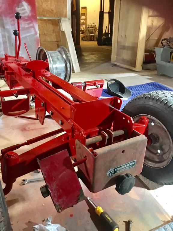

moe1965 766 #4 Posted July 30, 2019 (edited) I put a muel drive on a 854 to run a sickle bar. Biggest issue was wheel clearance when you turn left. It would hit the muel drive. I made a 1 1/4 space to shift it over to get the clearance it needed. Edited July 30, 2019 by moe1965 Added picture 1 1 Share this post Link to post Share on other sites
Racinbob 12,045 #5 Posted July 30, 2019 Wheel Horse made an adapter that bolted to the frame allowing the use of a front mount mule drive on the older tractors. I tried to find some info on it but couldn't Maybe somebody here can help. 1 1 Share this post Link to post Share on other sites
gwest_ca-(File Mod) 11,602 #6 Posted July 30, 2019 This one maybe Garry 2 Share this post Link to post Share on other sites
The Tuul Crib 7,339 #7 Posted July 31, 2019 Yep looks just like this! 1 Share this post Link to post Share on other sites
The Tuul Crib 7,339 #8 Posted July 31, 2019 On 7/30/2019 at 6:51 AM, Racinbob said: Wheel Horse made an adapter that bolted to the frame allowing the use of a front mount mule drive on the older tractors. I tried to find some info on it but couldn't Maybe somebody here can help. These can easily be fabricated out of 1/4 inch steel. All you need are dementions and where to drill the holes. Oh and a welder or a friend with one. Share this post Link to post Share on other sites
