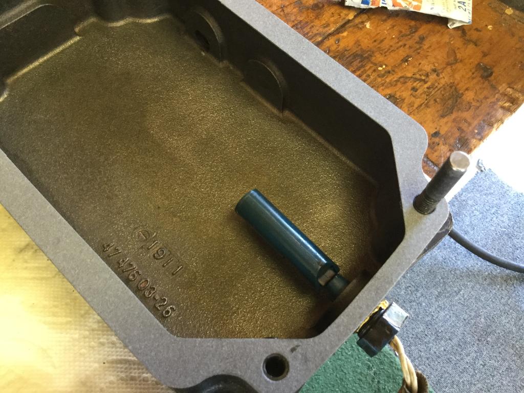

pfrederi 19,278 #3 Posted July 29, 2019 Unless the engine was recently opened up ol pan gasket leaks are not that common. Are you sure it isn't oil running down from the breather assembly on the front of the engine under the carb? If it really is oil pan gasket it isn't difficult as you 1985 didn't have a low oil switch. There were different oil pans used to be sure you get the right gasket what is the spec number of the engine??. 1 Share this post Link to post Share on other sites

pfrederi 19,278 #8 Posted July 29, 2019 (edited) 13 minutes ago, gwest_ca said: Here is the engine parts list but don't see spec 46849 in it. Garry and the Khler engine site is having issues again says it doesn't recognize my zip code so I cant look there There are only 2 gaskets one is for the small base block as used on the isolation mounts. Since the 310 is frame mounted the gasket would be 235057 large block. Edited July 29, 2019 by pfrederi 3 Share this post Link to post Share on other sites
