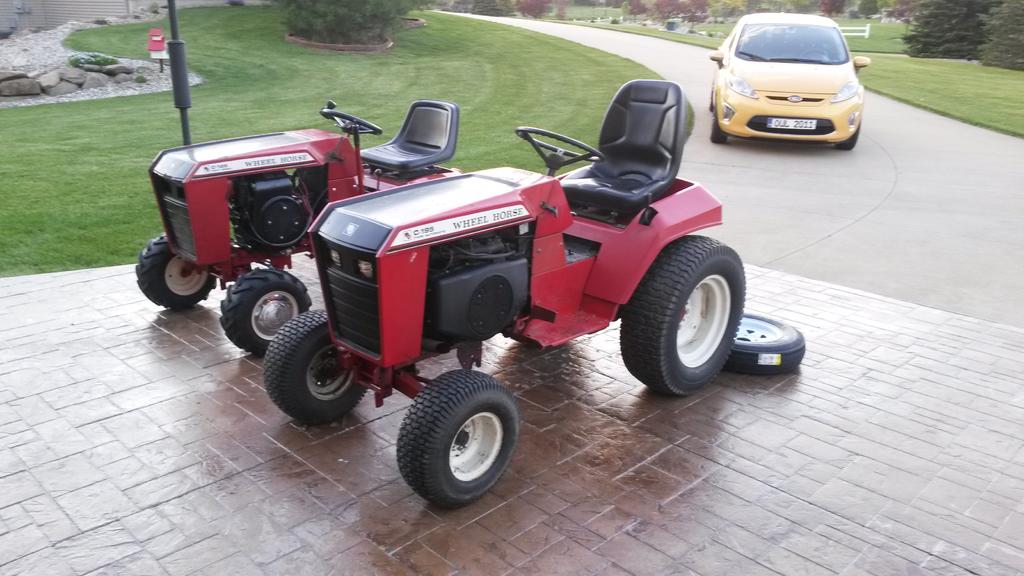

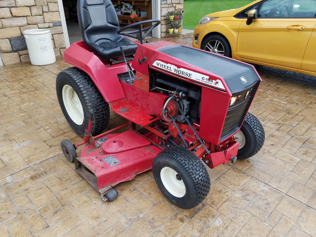

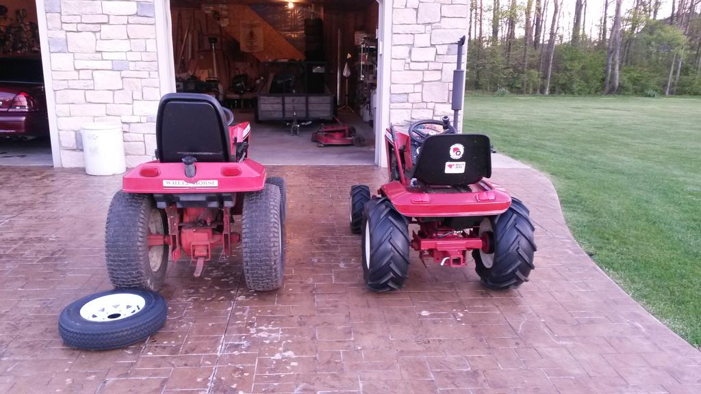

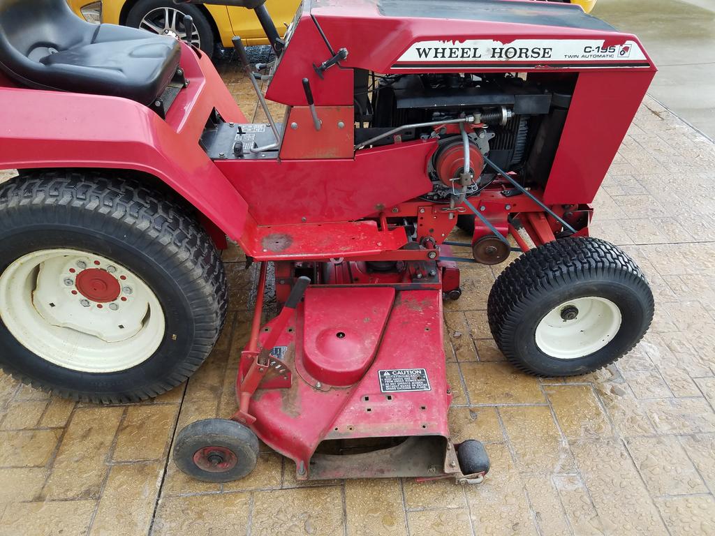

bds1984 1,506 #21 Posted July 30, 2019 Don't forget that a C195 had six-lug rims. Here is a picture of the 1984 Super C I regrettably sold sitting next to my 1984 C165. I believe the rear tires on the Super C were 27-9.50R15 and the fronts were 18-6.50R8. My C165 has since gained 18-8.50R8 turf tires on the front, NOS hood, and a regular muffler so it looks a little more the Super C. I believe where the frame of the C195 is lengthened is behind the foot rests to allow the machine to accommodate the larger diameter tires. I don't think I'd go moving the foot rests forward, it seems easier to add a few inches to the rear to me. 5 1 Share this post Link to post Share on other sites
