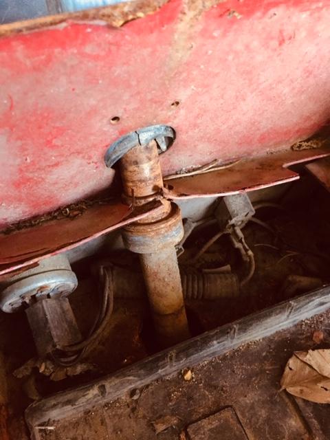

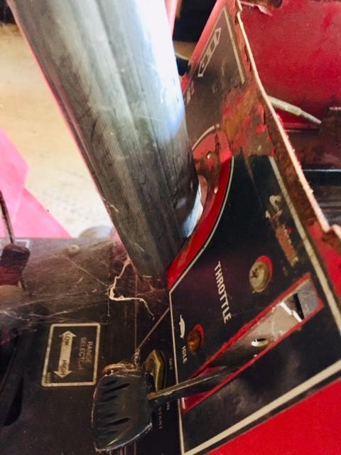

bigcreek 205 #1 Posted July 28, 2019 Gents, Rescued a much neglected 310-8 some time back, and now it is time to get her going, the steering seems extremely beat to hell, couple of images. My use for this tractor is into a good working mower, so I can park my less than 100 hour 314 hydro. My question is what all do I need to rehab fix or acquire to fix her steering right? Other fixes will include new tires all around, going with the orginal size 22x9.5-12 and 15x6-6 Deck rehab into working condition Electrical troubleshooting Many thanks in advance for any help Scott 1 Share this post Link to post Share on other sites
Lee1977 7,809 #2 Posted July 28, 2019 (edited) Here is the fix. Toro flange bearing No. 6472 May need to weld that back together and strighten it. The fan gear may also need shimimg to take out the slack. Edited July 29, 2019 by Lee1977 2 Share this post Link to post Share on other sites
bigcreek 205 #3 Posted August 1, 2019 Lee thank you, got the upper dash out and steering wheel shaft out, now trying to get the wheel off, but with regard to your fix, can you share any more info or images thank you Scott Share this post Link to post Share on other sites
