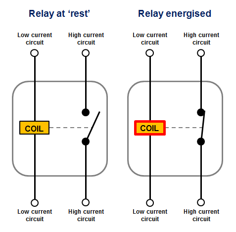

squonk 45,805 #5 Posted February 2, 2023 (edited) On 2/1/2023 at 9:32 AM, FarmerJon said: How would a person test that oil level relay? My volts going I to it are 13 but coming out to the solenoid is 1.7. My continuity seems fine on the two prongs though. Very confused. Your relay has 4 terminals. 2 for the relay coil ( 12 volt power and ground) and 2 to activate the internal contact (12 volt power and to solenoid) When cranking if you oil switch is made, power comes from that switch to one side of the relay coil. if the relay ground circuit is good (through the other coil wire) the coil is now energized. (click) Power is also coming from the key switch, neutral switch, PTO switch ect to the 3rd terminal (one side of contact) With the coil now energized the magnetic field of the coil closes the contact. Power now flows from one side of the contact to the other and out to the solenoid. "My volts going I to it are 13 but coming out to the solenoid is 1.7." Sounds like the relay contacts are not closing or are burnt Edited February 2, 2023 by squonk 1 Share this post Link to post Share on other sites
squonk 45,805 #6 Posted February 2, 2023 This is not you relay but the concept is the same. The" low current" is the oil switch circuit. High current is the solenoid circuit 1 Share this post Link to post Share on other sites
