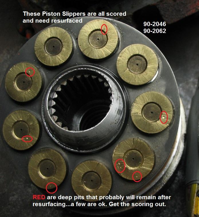

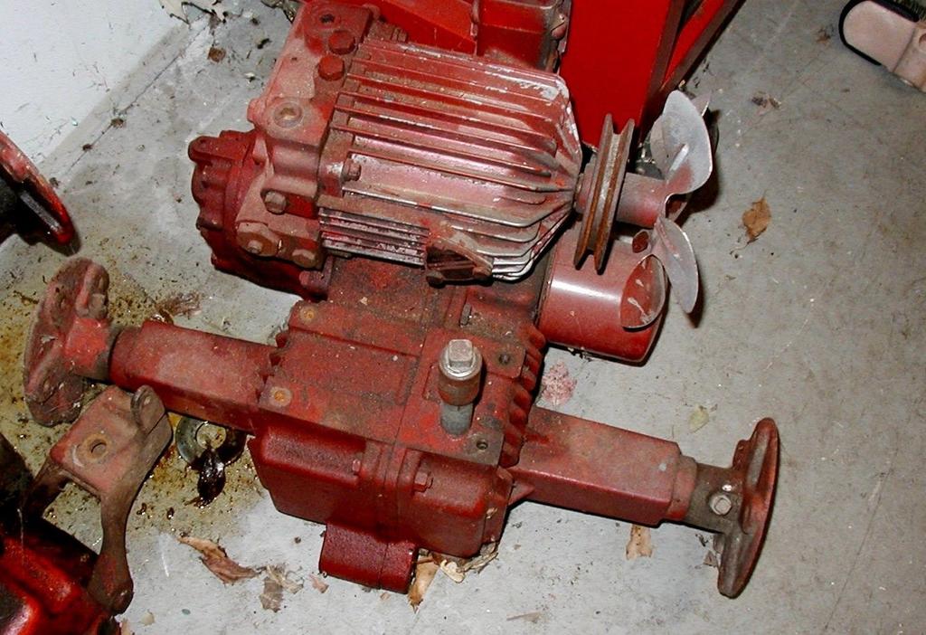

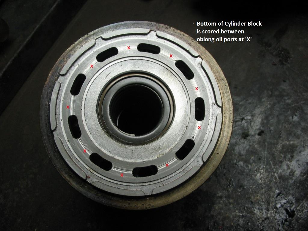

daveoman1966 3,881 #3 Posted July 26, 2019 Yours looks like this...RIGHT? That unit is essentially the Sundstrand HYDRO-GEAR and ...since it is 52+ yrs old....likely has worn out internal components. Over the years, sofr brass internal parts get scratched and oil HIGH pressure is lost thru those minute scratches, resulting in power loss. The only cure is to pull the complete Hydro-Gear and resurface the internal compomnents with fine grit sandpaper. I've overhauled many of these and it is not difficult...just meticulous and time consuming. You'll likely find brass parts scored like this: ...as well as others. Share this post Link to post Share on other sites
