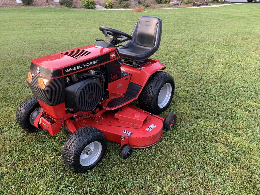

byoung36 18 #1 Posted July 26, 2019 (edited) Picked this up last week knowing nothing about the Onan or the 520.There was a miss in the engine which I thought at first was a spark plug or a coil issue. After a few post here and some great advice from members I ran a compression test only to find the rear cylinder had 0 compression. Further inspection lead me to find a broken rod, which I never would have suspected because other than missing the engine made no odd noises. I was able to source another p220 with 800hrs, so after a couple nights swapping everything this 520h runs like a new machine once more. I have had many WH tractor over the years all of which were 8 speed tractors with the exception of one which was a C-195. The C-195 was a great tractor but I was never impressed with the hydro trans, it always wanted to speed up going down hill. After using this 520 for a couple days nows my opinion on the this hydro has changed. I have been really impressed with this machine and I think I will definitely keep it around for a long time. Thanks you everybody for the help. Edited July 26, 2019 by byoung36 6 7 Share this post Link to post Share on other sites

byoung36 18 #8 Posted July 26, 2019 2 hours ago, pullstart said: That’s a pretty tractor! Did you mention how many hours were on it originally? 600hrs on the original machine. The reason the rod broke is a mystery to me. There was about a teaspoon of gas water mixture that came out when I took the head off, but the piston wasn’t stuck. The rod broke close to the crank and the bearing end came off the crank and is in the oil pan. I haven’t pulled the oil pan yet to investigate further. 2 Share this post Link to post Share on other sites
