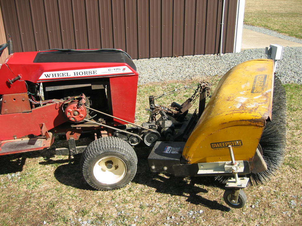

pfrederi 19,794 #2 Posted July 24, 2019 Do you have the spec number for the KT17?? that way we can figure out if it had a thrust bearing. Most KTs did not have the thrust bearing (cost extra) If it does not have it you can still use it but you will have to use an electric PTO. My sweepster C175 has a JD spec KT17 i had to use an electric PTO as in picture easy to do 2 Share this post Link to post Share on other sites

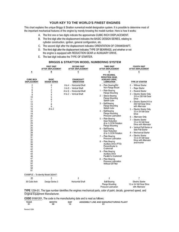

bds1984 1,506 #6 Posted July 30, 2019 The Briggs most likely has ball bearings on the crank but I'd check this chart just to be sure. Share this post Link to post Share on other sites
