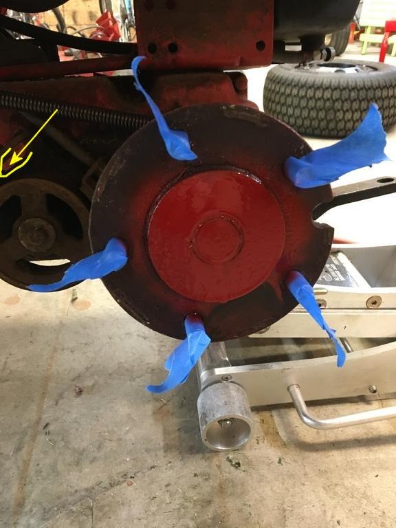

Sparky-(Admin) 24,853 #2 Posted July 21, 2019 Pop off the left rear tire and the spring is right there, totally accessible. You can kinda see it in my picture. I’m not a fan of “hardware store” springs as you end up with either to much or to little tension. 4 Share this post Link to post Share on other sites

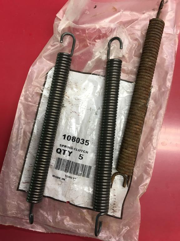

WVHillbilly520H 10,378 #3 Posted July 21, 2019 https://www.jackssmallengines.com/jacks-parts-lookup/part/toro/108035?gclid=cjwkcajwmtdpbraqeiwac6lm48vt1xgy26rznp-mbgu7b6vl1l75u7vrx5py5cpygpwoiwupn3rxaxocqp4qavd_bwe 2 Share this post Link to post Share on other sites
