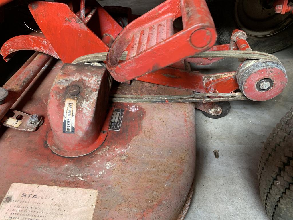

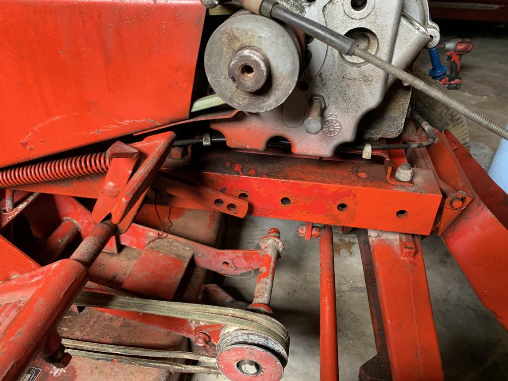

Fireguy0311 20 #1 Posted July 21, 2019 I recently got a 656 with a deck and blade. The blade was installed when I picked it up, but I’d like to get the deck on there. I have never installed a Wheel Horse deck and I’m not quite sure where to start with this thing. Does anyone have a tutorial on how to install these decks? I’m not even positive i have all the required parts to be honest. Share this post Link to post Share on other sites

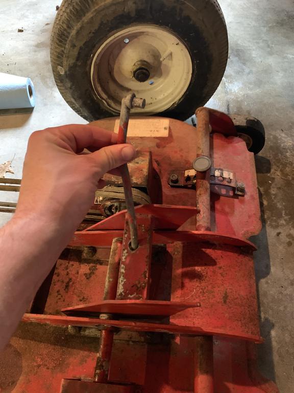

Fireguy0311 20 #2 Posted July 21, 2019 Okay, I got it mostly figured out except for this piece. Share this post Link to post Share on other sites

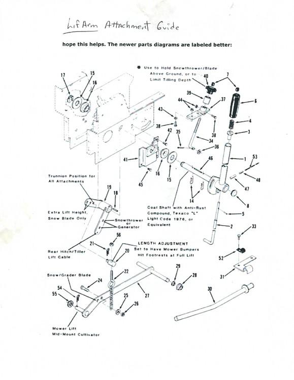

cafoose 3,635 #3 Posted July 21, 2019 The previous is what I found on the mower deck without more details not sure which deck you have but this should help. Tractor manual is in the last link. 1 Share this post Link to post Share on other sites
cafoose 3,635 #4 Posted July 21, 2019 4 minutes ago, Fireguy0311 said: Okay, I got it mostly figured out except for this piece. That goes to the lift link 1 1 Share this post Link to post Share on other sites

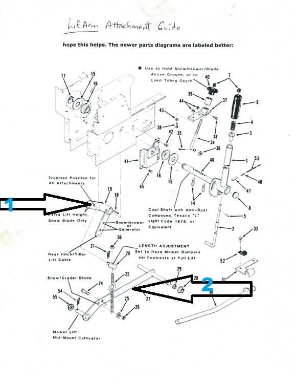

cafoose 3,635 #5 Posted July 21, 2019 Arrow 1 is where the lift link attaches, arrow 2 is not on your tractor only on later models such as B or C series in the 70's 1 Share this post Link to post Share on other sites
