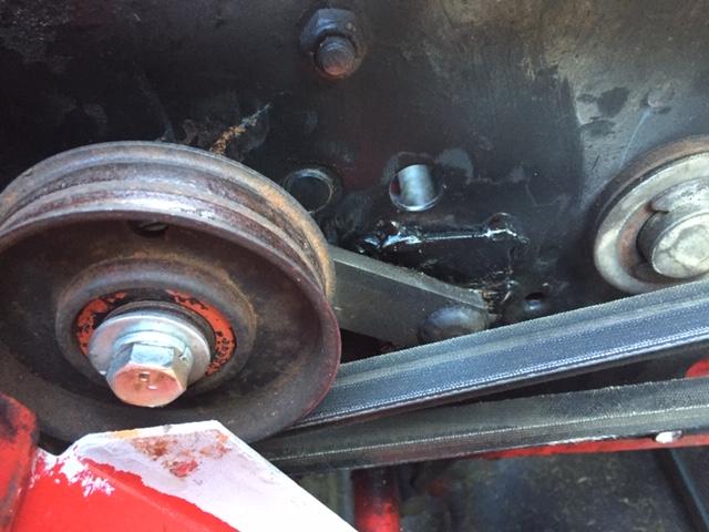

dalez 148 #1 Posted July 20, 2019 (edited) Bought a 97 416-h recently and when I got it home it seems like it may have more hours than the hour meter reads (622). I checked things like the steering, hydro, etc. Started to tear it down to fix obvious problems before using it and found the drive belt idler shaft worn and bushing in frame eggshaped. Would this go in that amount of hours? Pretty sure the wrong pulley was on it also. Drilled the frame out to 5/8" and welded a 1/8" piece of steel to thicken the frame, added bronze bushings and seems good to go. Either one front tire had been replaced or three tires were replaced and one was left original. The 3 matching tires are DICO I don't know what brand they originally came with. Mower deck looked great. I actually thought I had one that would require no welding until i started wire brushing and banging off rust. Lots of holes. I don't think the seller would of been to happy if I got out a hammer and started banging on the mower deck looking for rust holes (but my fault for not removing it and checking it out better). Other things were lots of rust and pitting on footpads although the the rubber pads were in excellent shape. Levers had worn out Nylon bushings. Paid $600. The engine and the Hydro work fine so I just have a lot of miner repairs. I guess my question is "When looking at a tractor what would make you question the working hour meter? Also do we have a tractor buying stickie anywhere? Things to check? I will be more cautious next time but I had been wanting a hydro so kinda jumped the gun. Edited July 20, 2019 by dalez Share this post Link to post Share on other sites

ohiofarmer 3,389 #18 Posted July 21, 2019 (edited) 20 hours ago, dalez said: I think I will chalk a lot of it up to sitting outside in eastern Massachusetts. Paint on panels and was bubbling underneath like described in an earlier post. Transmission and frame paint looks fine. I couldn't believe the thickness of the rust under the deck it was coming off in layers. I knew I was in trouble when I gave it a whack to loosen up some rust and the hammer broke through the other side. Thanks for the knowledge and ideas. I will post pics of the repairs I made soon. Please do post those piccs. I keep warning people about the egg out of the thin sheet metal around the idler. Trouble is that the only time you even see it is when you remove the belt guard. Another weak area is where the seats bolt on. If you lean your weight to the side when mowing side slopes, the cantilever mounts exert tremendous pressure on the sheet metal of the transmission tunnel and they crack and fail. Thin sheet metal is the culprit of both problems. I have a 416 and the idler was supported with an air shock which keeps the vibration down. So maybe Toro became aware of this problem at some point. Edited July 21, 2019 by ohiofarmer Share this post Link to post Share on other sites

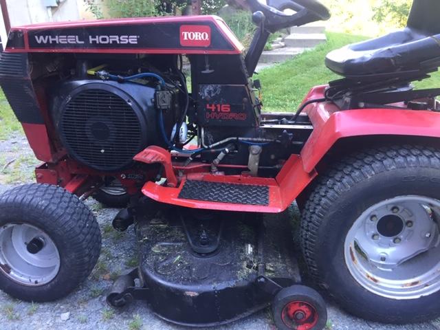

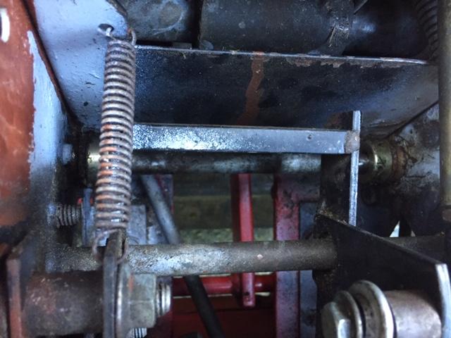

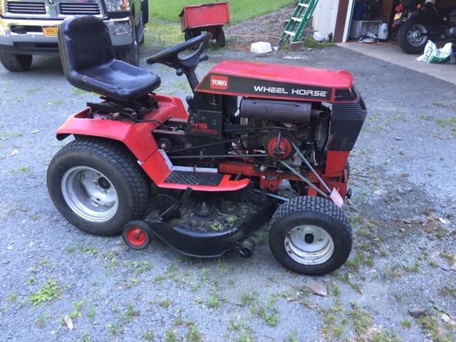

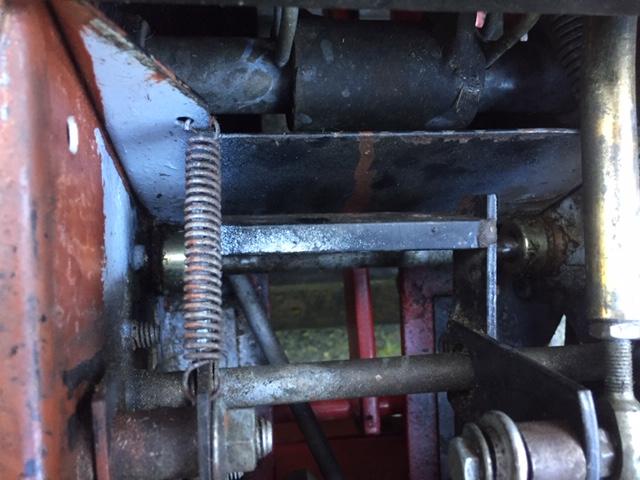

dalez 148 #19 Posted July 21, 2019 Attached some photos of the idler arm assembly repair. Removed old bushings. almost seemed like they were attached to frame. Drilled frame out to 5/8 Welded 1/8 steel plate with 5/8 hole to outside of frame on each side Installed 5/8 x 1/2 bronze bushings with Flange on inside. Keep it all together with locking collars on the inside against the flanges. Couple pics of the tractor with an old deck I use. Share this post Link to post Share on other sites
